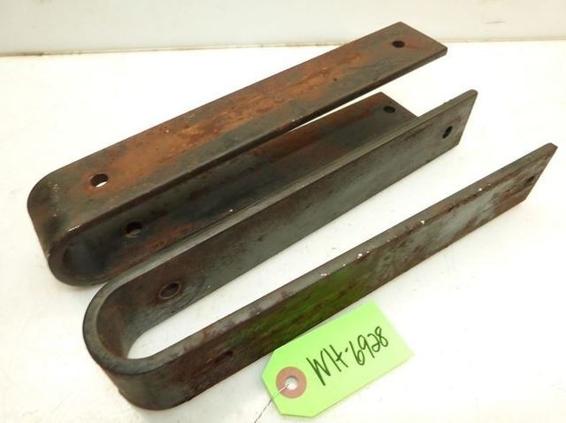

CasualObserver 3,415 #12 Posted July 14, 2016 I took a set of springs like these from a later model and raised my seat on my Raider. Much more comfortable ride. 2 Share this post Link to post Share on other sites
Wheel-N-It 2,978 #13 Posted July 14, 2016 The springs are a great idea. Never owning a Raider, I was unaware they did not have seat springs. Share this post Link to post Share on other sites
