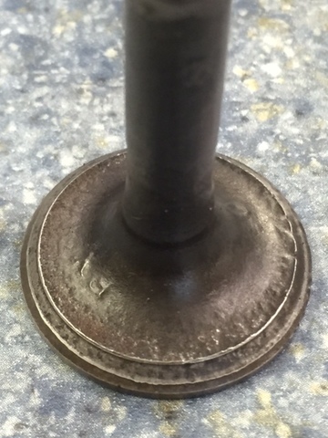

TimH 105 #1 Posted July 11, 2016 Old guy down the street ask me to look at his Horse Has a KOHLER 12 HP Over 900 Hours on engine. Said all he ever did was Oil changes and lubed It stopped running on him No compression So I took the head off and found the EX valve stuck open. Now he wants to replace the whole engine. His Horse is a 87 Looks pretty good for its age. Were is the best place for him to order a new engine ? Share this post Link to post Share on other sites

Shynon 7,505 #3 Posted July 11, 2016 I would rebuild it. 3 Share this post Link to post Share on other sites
ACman 7,675 #4 Posted July 11, 2016 I'm with @Shynon ! 2 Share this post Link to post Share on other sites
TimH 105 #5 Posted July 12, 2016 Rebuild He doesn't know how and I don't have the time. Thanks I will look at Northern tool 1 Share this post Link to post Share on other sites
elcamino/wheelhorse 9,362 #6 Posted July 12, 2016 Old guy down the street may not be aware of the price on a new engine. Make sure he is sitting down before he learning of pricing. Rebuild the motor. 4 Share this post Link to post Share on other sites
TimH 105 #7 Posted July 12, 2016 I looked a new engine up $ 749.00 with my Honda dealer discount . He told me to order it for him . I just wonder how long it will take him to change the engines out 1 Share this post Link to post Share on other sites

prondzy 3,889 #10 Posted July 13, 2016 For that price I would take it to a small engine shop and have them rebuild it! Twice the motor over the honda 2 Share this post Link to post Share on other sites
TimH 105 #11 Posted July 13, 2016 Just picked up a Honda engine 695.00 Took my guys 2 hours to install Runs great 1 Share this post Link to post Share on other sites
