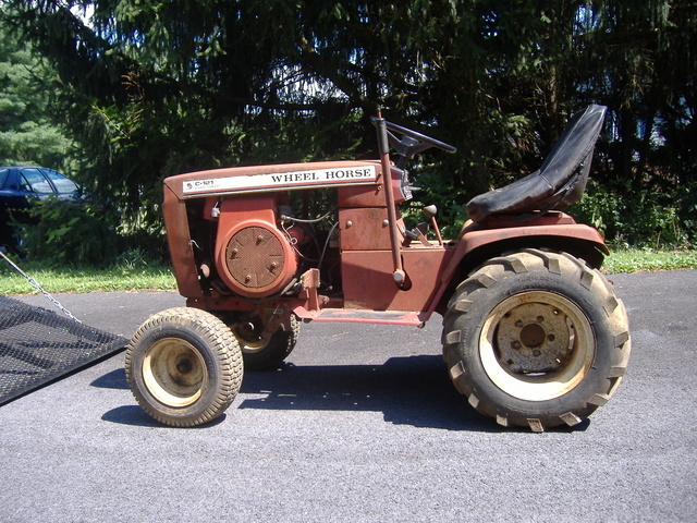

RJ Hamner 1,029 #14 Posted July 12, 2016 Well here she is. Fresh off the trailer. Share this post Link to post Share on other sites
Wheel-N-It 2,978 #15 Posted July 12, 2016 (edited) You got AG's !!! Yours looks to be in pretty decent shape! I'll have to post a couple of pics of mine. I really like how yours looks with the AG tires. Edited July 12, 2016 by Wheel-N-It Share this post Link to post Share on other sites
