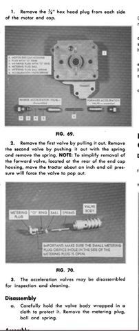

953 nut 70,056 #2 Posted July 11, 2016 The first step with any Hydro performance problem is to replace the fluid and filter. Since you have Type F ATF continue using it, the NAPA filter number is 1410. This will probably fix the problem. It could be one of the "Acceleration Valve" springs on the Reverse valve needs replacement. They modulate the fluid flow to keep the operation from being jerky. If the fluid and filter change does not clear the problem let us know and we will continue on. Share this post Link to post Share on other sites

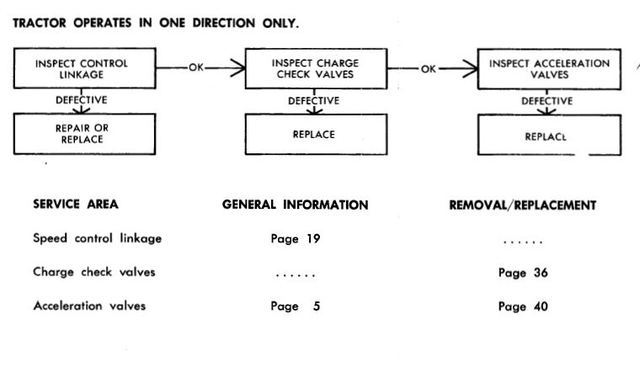

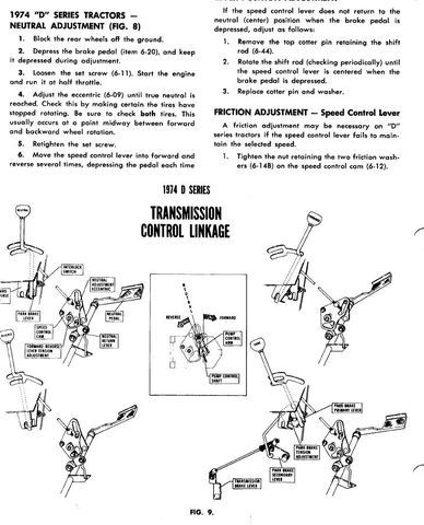

pfrederi 21,274 #5 Posted July 18, 2016 The sunstrand manual you can download here is the place to start. http://www.wheelhorseforum.com/files/file/24-transmission-hydro-sundstrand-sm-492-4206pdf/ The linkage adjust would be the tart. That is not hard to do. If that doesn't resolve it then the Charge pump check valve or acceleration valve issues require significant work. Not a afternoon project in the driveway. There are several threads here about repairing sundstrands. 2 Share this post Link to post Share on other sites
