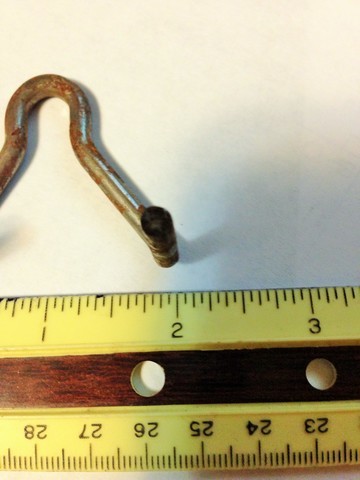

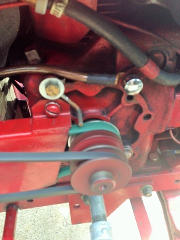

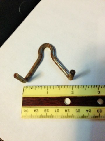

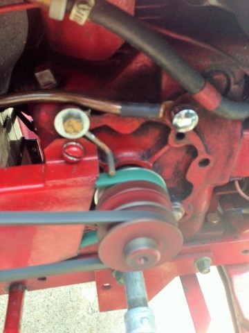

Lane Ranger 12,167 #28 Posted July 24, 2016 (edited) Chris: Send me you mailing address and I will send you one of these. I made my top belt guide out of this. I used a Dremel to cut off the top part in front of the U shaped part where the bolt goes into the motor. You can use on bottom or top depending on where you need it. The 701 and 702 belt guards did not have the later design features on them that the 1963 belt guards had be catching the drive belt when you use the clutch. They used these wire belt guides. I do not know the guarge of the wire but this is a good size. I have made guides using a little smaller guage wire and they worked just as well, I also placed a larger washer in front of the wire guide also. I used a washer on the lower bolt behind the belt guard to make sure it pumped out further too. Also -although you can barely see the wire under the bolt I have a wire belt guide on the underneath of the belt (and motor pulley) at the front of the belt guard too. Edited July 24, 2016 by Lane Ranger 2 Share this post Link to post Share on other sites
