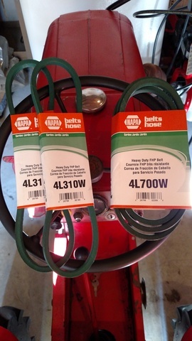

Wheel-N-It 2,978 #18 Posted July 13, 2016 Another baby step of progress was made yesterday. I picked up the belts at NAPA but could not do any wrenching last night due to having to be at a dinner meeting. I probably will have to work today till around 7pm so I'm not sure about working on the 701 after I get home. But here is a pic of the belts with the part numbers for the records. I am very grateful to those who chimed in with advice on what belts to buy. 5 Share this post Link to post Share on other sites

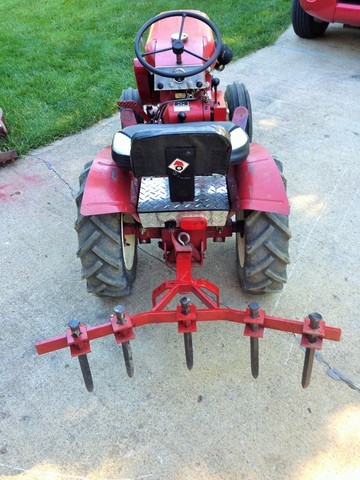

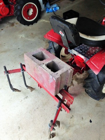

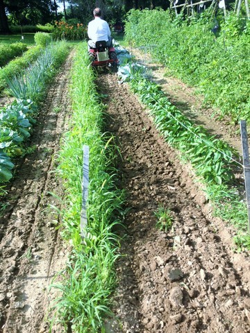

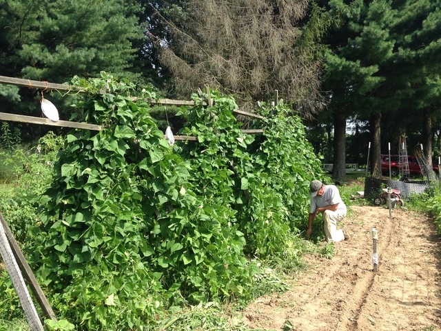

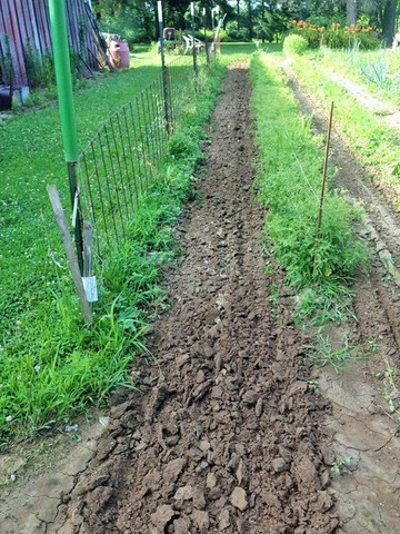

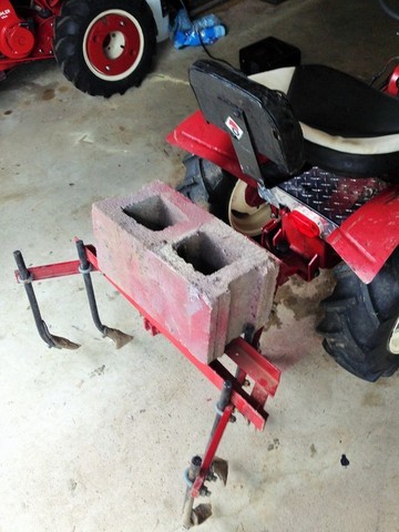

Lane Ranger 11,980 #21 Posted July 13, 2016 (edited) Wheel-N-It : You are going to love that 701 the more you get to use it -no doubt about it. I use my 701 with the hydraulic pump in my vegetable garden each year and it is a great working tractor for all we need to do. sheared a pin or bolt on my rockshaft the other day and had to reinstall a pin so I used a hitch pin. I ran my starter generator on one belt for about a year and finally bought two new NAPA belts like you bought when my old one gave way . posted a video of the hydraulic pump lifting the block on the nine shovel cultivator I use in the garden between the rows. 015.MOV Video of the hydraulic lift working. 015.MOV Edited July 13, 2016 by Lane Ranger 2 Share this post Link to post Share on other sites

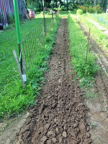

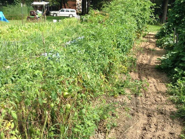

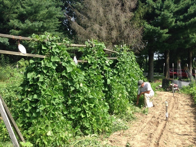

Wheel-N-It 2,978 #22 Posted July 13, 2016 (edited) Lane, thats a nice 701 you have. Jay was telling me at the Big Show about how you tend to a garden every year with your 701. That says alot about how tough these little tractors still are after all these years. I actually knew very little about the roundhoods even after being a Supporter here and attending the Big Show. I did not even know the 701 was the first little Wheel Horse tractor with the engine in the front. About a year ago I saw this one for sale on CL in the next town over. Turns out the guy who owned it was a Cub Cadet collector who somehow acquired a Wheel Horse. I understand that as I'm a Wheel Horse collector whom somehow acquired a Cub Cadet. Anyway long story short, the 701 came home with me that day, and I'm actually growing quite fond of it. I read your posting about using the hitch pin, and wondering if it is a good idea. I think that was a good idea as installing the hitch pin was probably a lot easier and faster than another nut and bolt. Edited July 13, 2016 by Wheel-N-It 2 Share this post Link to post Share on other sites
Wheel-N-It 2,978 #24 Posted July 14, 2016 Lane you got a big green thumb to go along with that little red tractor. That's a beautiful garden! Well done friend That's definitely a garden to be proud of! 2 Share this post Link to post Share on other sites
