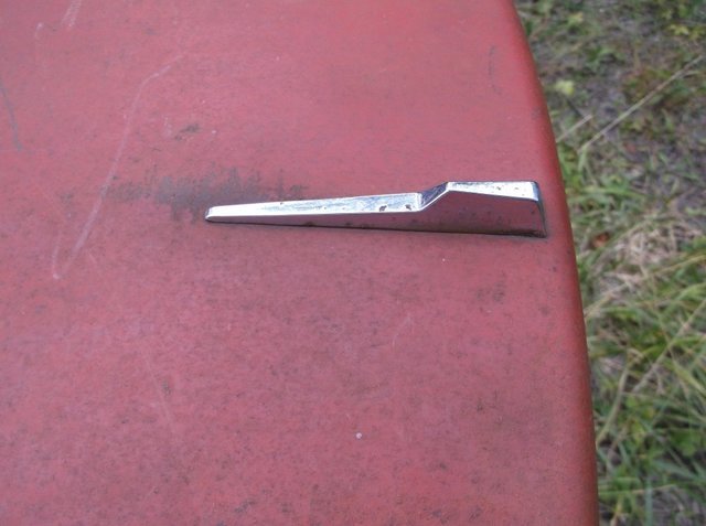

rmaynard 17,583 #10 Posted July 8, 2016 Does it have a hood ornament? 1974/75 had ornaments, 1976/77 did not. Just makes it easier to locate the correct manual for your C-120 1 Share this post Link to post Share on other sites

WheelHorse-fan 3 #12 Posted July 9, 2016 11 hours ago, rmaynard said: Does it have a hood ornament? 1974/75 had ornaments, 1976/77 did not. Just makes it easier to locate the correct manual for your C-120 Yes it did have an ornament Share this post Link to post Share on other sites
