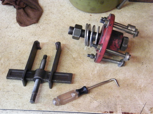

stevasaurus 23,816 #4 Posted July 6, 2016 (edited) Those videos will be very helpful. You happen to have the same Raider 10 that I do. 1972 and you should have a #5086 transmission. You do not have the 10 pinion, limited slip differential...you have a regular 4 pinion differential with 1" axles. The 1" axles are something to note when you order axle seals. The other Raider 10s have 1 1/8" axles. This should be a piece of cake when you get into it. @racinfool40 (Mike) might have any parts you may need. I flagged him, so he may come in a take a look. Be very careful when taking those hubs off...they are a 5 bolt pattern with a 1" hole for the axle. Some guys on here lately have been looking for some and they seem to be a little hard to find. Use or make a puller...no hammers. The puller you may end up making will look something like this...top right. Edited July 6, 2016 by stevasaurus 2 Share this post Link to post Share on other sites
