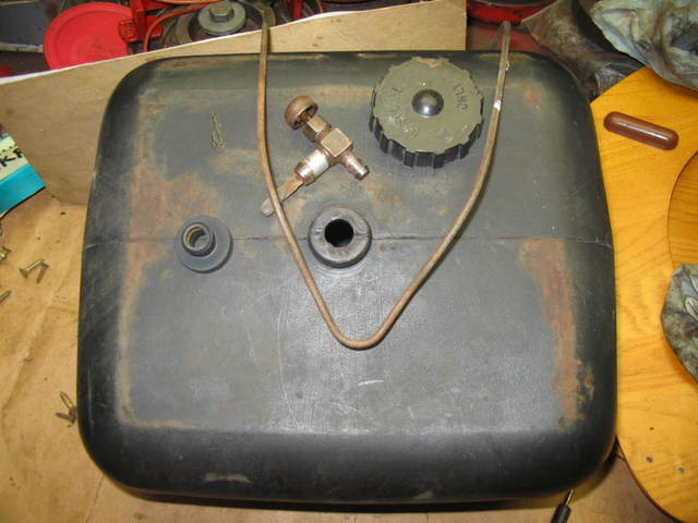

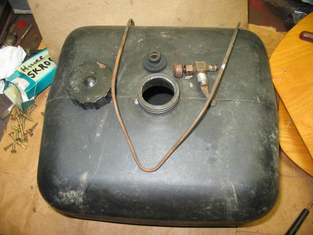

WHnewbie 2 #1 Posted July 4, 2016 Hi folks, I am a proud owner of a C160 I just purchased. I was wondering if anyone knows of an alternative source for a fuel tank. The neck on mine has somehow been broken off. I'm dying to get this old girl running again so any help will be greatly appreciated!! Share this post Link to post Share on other sites

MikMacMike 494 #5 Posted December 11, 2019 On 7/5/2016 at 12:46 AM, daveoman1966 said: I have a replacement tank, Sent you a PM a few minutes ago. contakct me directly at: daveoman@windstream.net Bruther, DO not toss it.....you can weld plastic......I do it to the plastic fender covers on your bumbers too, I always save the zip tie ends and use them like welding rods. Try to find out what type of plastic it is and use the equivalent n make your own rods to weld with. Youll probably make it stronger then when it was 1st manufactured too!!! Another way is to do like we do in plumbing is add a compression fitting with a female thread to screw the shot off back in.....very easy n cheap. Share this post Link to post Share on other sites
ohiofarmer 3,475 #6 Posted December 14, 2019 On 7/4/2016 at 1:14 PM, WHnewbie said: Hi folks, I am a proud owner of a C160 I just purchased. I was wondering if anyone knows of an alternative source for a fuel tank. The neck on mine has somehow been broken off. I'm dying to get this old girl running again so any help will be greatly appreciated!! I do not know what you mean by neck being broken off. if the nipple is broken off watch this video for the exact parts you need to fix it. 1 2 Share this post Link to post Share on other sites
ebinmaine 80,600 #7 Posted December 15, 2019 On 12/13/2019 at 9:16 PM, ohiofarmer said: I do not know what you mean by neck being broken off. if the nipple is broken off watch this video for the exact parts you need to fix it. @MikMacMike Here's the info to fix the tank I told you about. @ohiofarmer thanks for posting that !! 1 Share this post Link to post Share on other sites
MikMacMike 494 #8 Posted December 15, 2019 5 hours ago, ebinmaine said: @MikMacMike Here's the info to fix the tank I told you about. @ohiofarmer thanks for posting that !! Oh neet and quick way to fix thanks Ebinmaine. I was thinking if there was say a crack in the tank wall its able to be welded, but as for the supply line side at work we have what they call a bulkhead fitting. Its really the same as in the video but theres a nut on the outside that youd tighten and on the tube itself you can either get a female or male thread. But I will say the fitting your suggesting is far faster. Hi 5 brother. 1 1 Share this post Link to post Share on other sites
