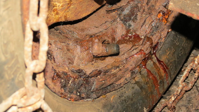

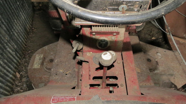

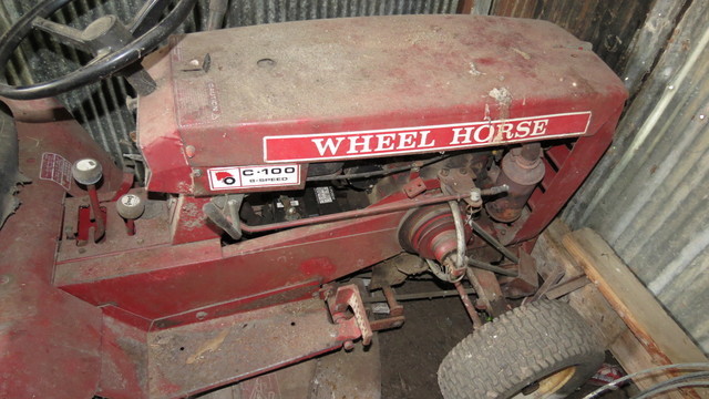

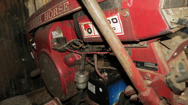

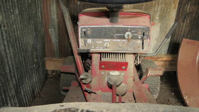

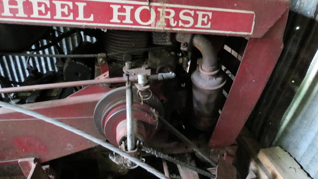

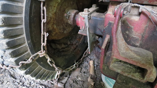

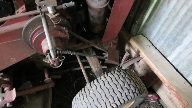

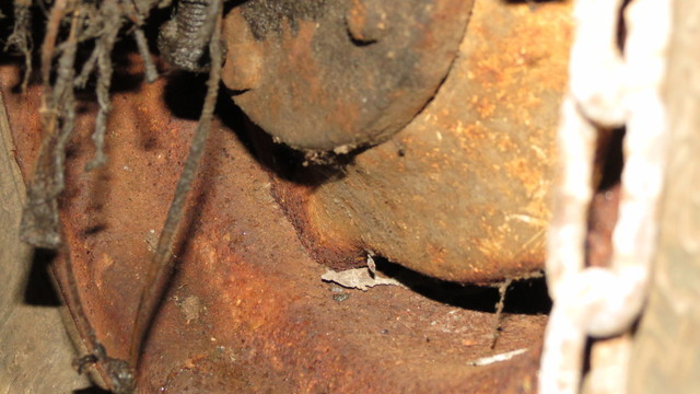

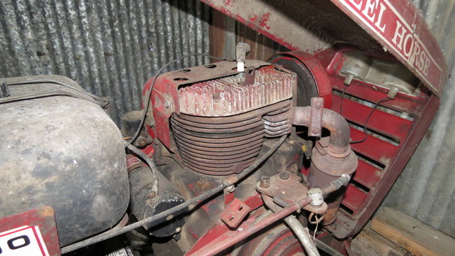

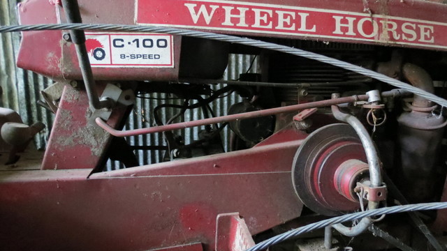

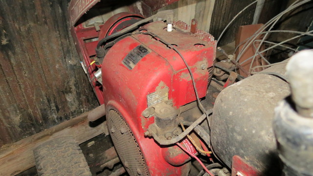

jec34817 9 #17 Posted July 9, 2016 OK OK LIke I said Im a newbee here! But I can take it. haha Im sorry, its not a C200. Its a C120. My wife is pretty attached to the C100 though. I took a bunch of pics of the C100. Tell me what you all think. Is it restoreable? The say it ran when the Father in Law put it in the shed. Its been in there for 5 years or so. Hope the pics load. Its the condition of the rear wheels that really concern me. Sorry it took so long to get back to you all 3 Share this post Link to post Share on other sites
C-101plowerpower 1,606 #18 Posted July 9, 2016 overall it doesn't look to bad, although that rim looks nasty 1 Share this post Link to post Share on other sites
jec34817 9 #19 Posted July 9, 2016 (edited) Yeah thats what scares me. I seem to remember him saying that he had something put in the tires for added weight. I think that might be what it is thats seeping out Edited July 9, 2016 by jec34817 needed to add more content Share this post Link to post Share on other sites
roadapples 6,987 #20 Posted July 9, 2016 Wheels are easy to find, and not that expensive. I wouldn`t use those tires either. Also, remove them outside. Calcium eats concrete! Otherwise, tractor looks pretty good. Nice find and keep us updated.. 1 Share this post Link to post Share on other sites

Horse46 519 #22 Posted July 9, 2016 Give it a wash, I bet it would look 100% better straight off. Take em both the addiction will set in soon any ways. 3 Share this post Link to post Share on other sites
TDF5G 2,074 #23 Posted July 12, 2016 That tractor is certainly worth saving IMO. It appears to be complete. Looks like you'll need a set of rear tires and wheels, but that is an easy fix. They appear to be filled with calcium for weight, which is very corrosive too. And have fun with your project. 1 Share this post Link to post Share on other sites
