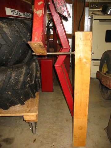

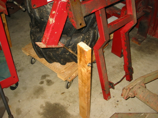

pfrederi 21,231 #4 Posted July 3, 2016 I have an Arc on a d series. It has quick connects do getting it off isn't too bad. Set the bucket on the ground put the supports into the ring on the foot of the upright. They will lie at an angle. Then standing on the tractor I lift up in the cross bar. Have the lift valve in the float position. The support legs will swing until they are vertical and you can back the tractor out. Make sure you make the 2x4's long enough so eh front tires will pass under the uprights. 1 Share this post Link to post Share on other sites
