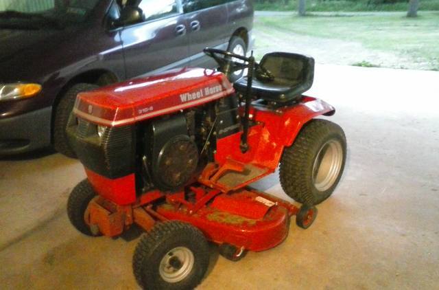

WHX?? 58,307 #18 Posted July 5, 2016 Thats an old one and would look cool on the front of an RJ or Suburban!! ...just my would have to fab a bracket. What model tractor do you plan on putting one on erwine?? 2 Share this post Link to post Share on other sites
erwine13b 27 #19 Posted July 6, 2016 310-8 this one a 310-8 Share this post Link to post Share on other sites
