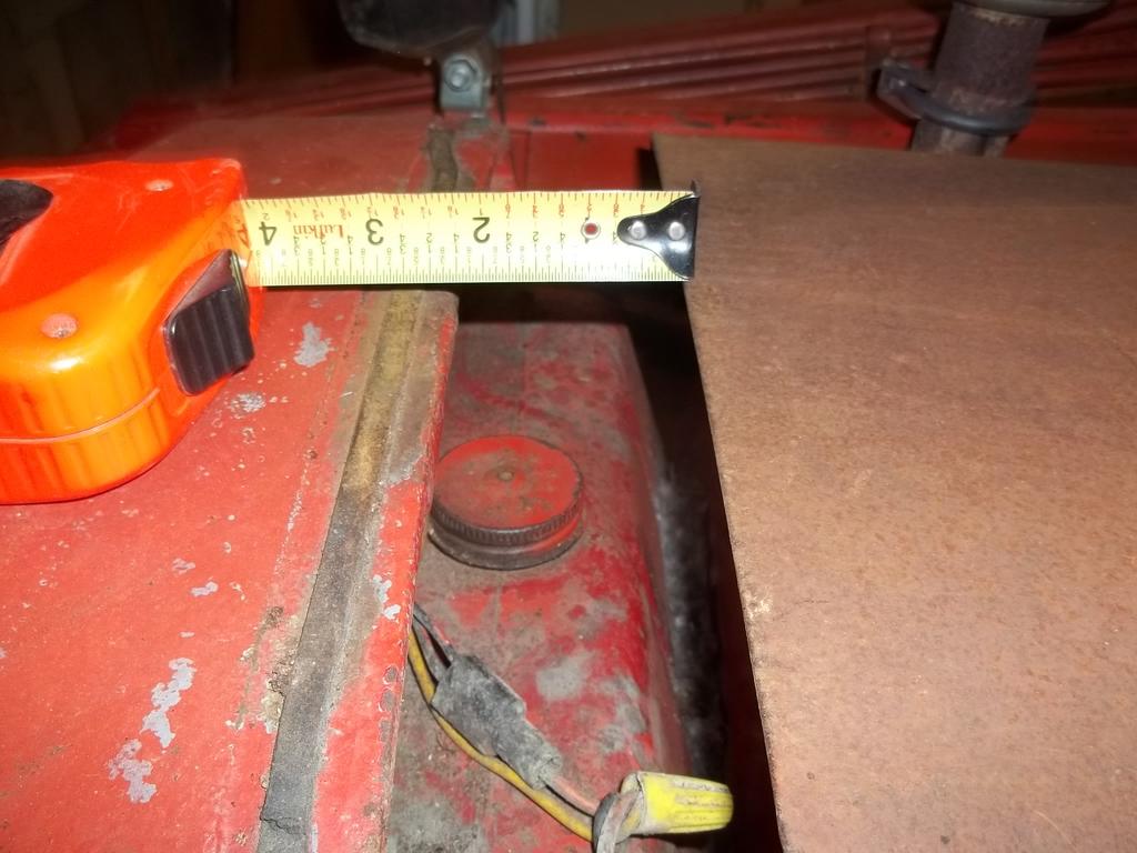

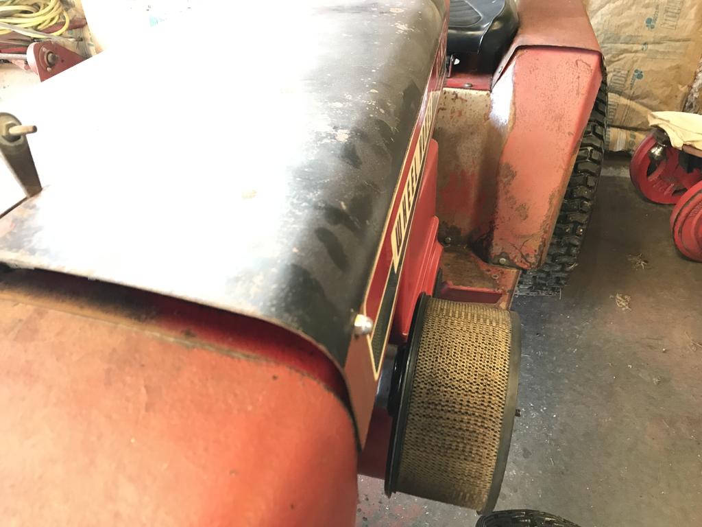

RandyLittrell 3,946 #76 Posted August 27, 2019 It may be too late for this now, but it looks to me if you had some K341 sheet metal instead of the M16 it would clear the hood. Hate to see ya have to cut the hood. Randy 1 Share this post Link to post Share on other sites

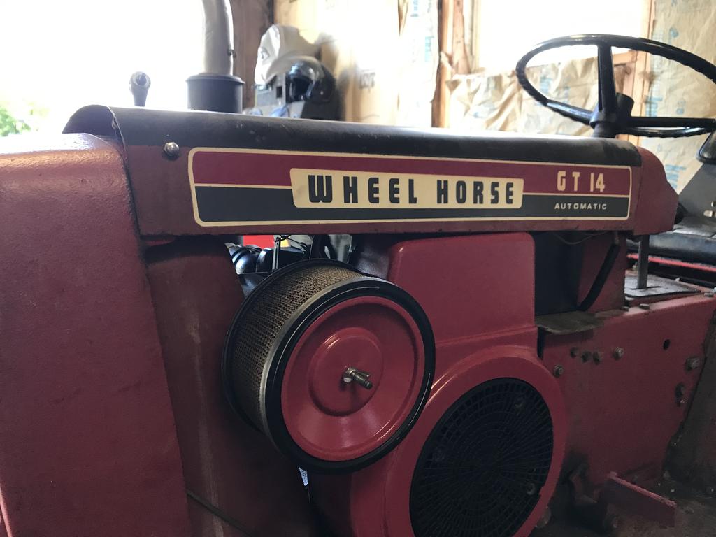

PeacemakerJack 11,096 #77 Posted August 27, 2019 1 hour ago, WHX24 said: How close is that hood to a 953 hood? I have a spare that's already been cut. Get that seat off and put an old pos on for temp. That original looks too nice to be beating up on a plow field! That a Sportster sittin next to old yeller? Not sure on the hood comparison. Maybe someone else on here knows better than me, I could measure dad’s 953 and compare. That seat was the one that came with it as I mentioned on the first page. It is in great shape for its age. That is cousin Paul’s sporty. His stuff always has a way of migrating to my place😉 When I said it was close... It seems to me that I could take the spare hood that I have and belly both sides equally in the same spot just to clear that rear corner of the engine tin by a quarter inch and I’ll be good. Dan/Kevin (fab guys) what do you think? Randy—that’s the problem...I didn’t have a K341 Tin at my disposal. There are enough differences between that and the Magnum that I’m still not sure it would’ve worked. Good thought though. Richie suggested modifying the engine tin to clear. I liked that idea but I wasn’t patient enough Once I get a few more of these details ironed out, should be ready to put the mower deck on and try it out in a real world application once again! If i I feel like the governor isn’t opening up fast enough or at all, which way do I go with changing the hole that the spring is in? 1 Share this post Link to post Share on other sites
RandyLittrell 3,946 #78 Posted August 27, 2019 If you have a spare hood, thats what I would do too. Save the good hood for the rebuild later. Doesn't look like it will take much. Randy 2 Share this post Link to post Share on other sites
Achto 32,962 #79 Posted August 27, 2019 (edited) Given the fact that you have two hood, I think that I would belly one out to fit this application. Does the hood have a rolled or folded edge on the bottom? If it doesn't, you could also cut one of the hoods to gain your clearance. The cut out could be easily repaired at a later date. Edited August 27, 2019 by Achto 1 Share this post Link to post Share on other sites

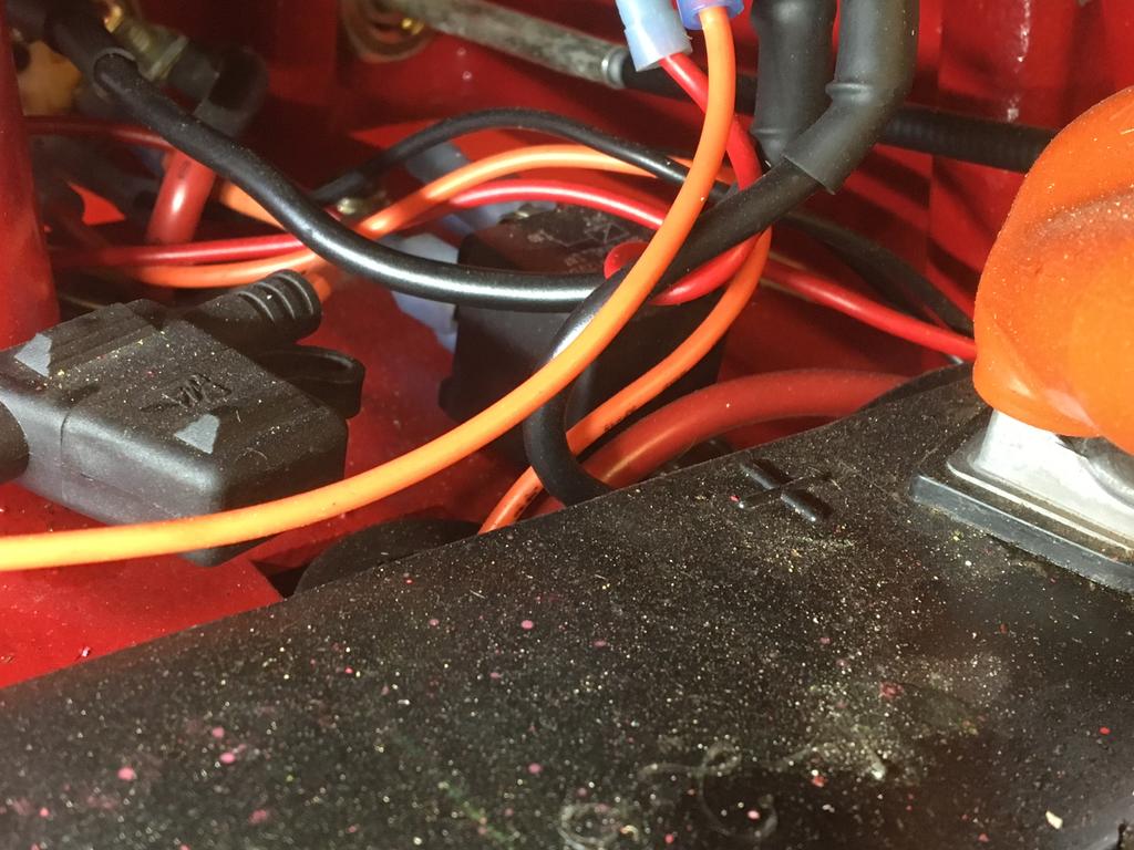

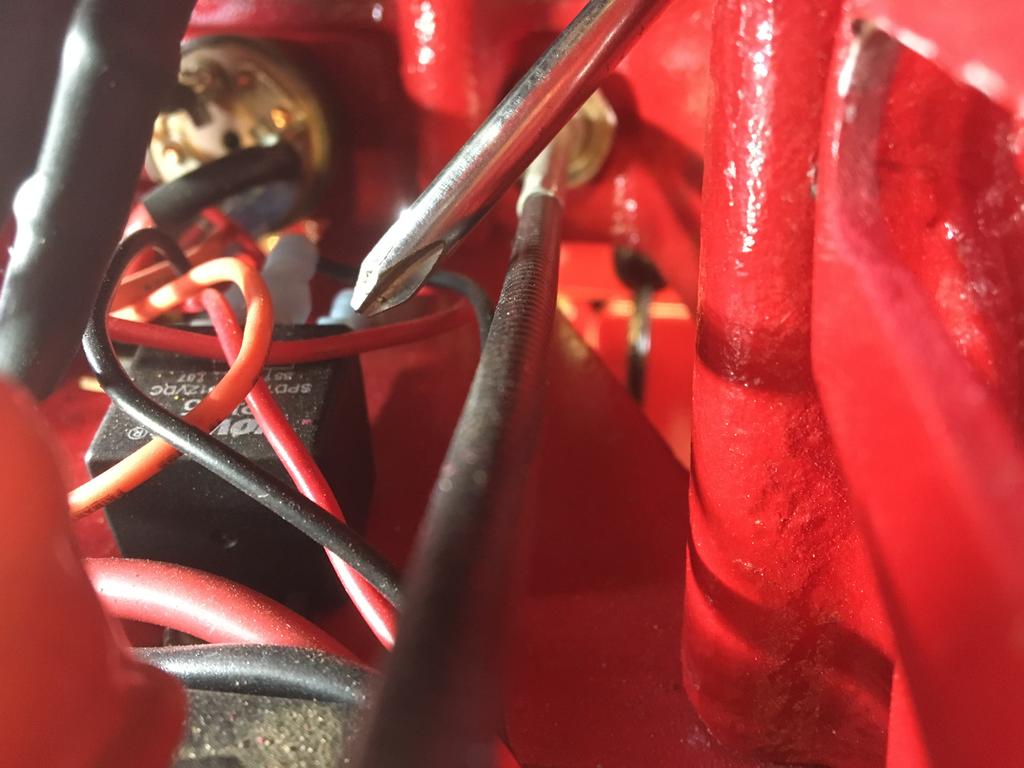

p38js 444 #80 Posted August 27, 2019 Peacemaker Jack, Sorry it took so long to reply, all of a sudden I got busier than a one armed paper hanger. I used a 12v relay from advanced auto and attached it under the switch to the mounting bolt already there. Hope this helps 1 1 Share this post Link to post Share on other sites
Pullstart 71,561 #81 Posted August 27, 2019 I guess you can see in this post how much I stretched the side of Frank’s hood, but I had some filling to do when it was all said and done. 1 1 Share this post Link to post Share on other sites
19richie66 17,951 #82 Posted August 27, 2019 Send me that M16 shroud and I’ll fix it for you. 1 2 Share this post Link to post Share on other sites

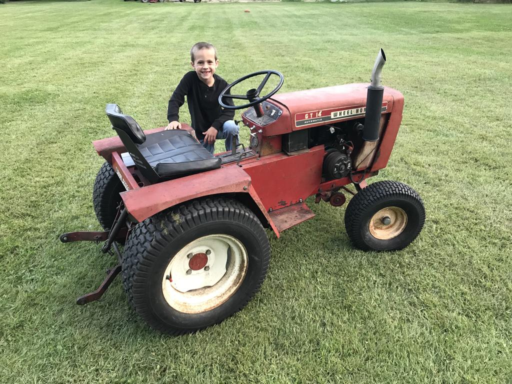

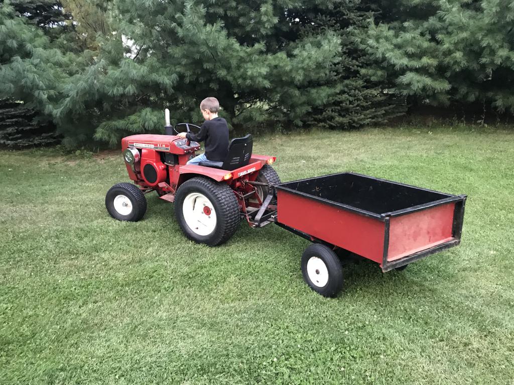

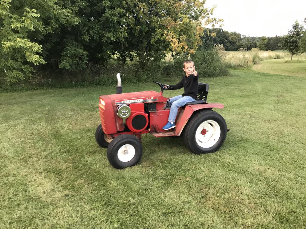

PeacemakerJack 11,096 #83 Posted September 2, 2019 A quick update (headed out to camp out in a tent with the boys in our back acre!)... After much thought, I elected to cut the spare hood that I had. Zach wanted the “bling” of the chrome air cleaner and when one of those showed up—he was overjoyed! I was going to cut the tube off of it but Judge said, it looks like a pirate earring if you leave it hang down—works for Blackbeard. Here is your calendar shot. Does this little man look proud of his tractor or what? He drove it around for awhile but then wanted to work it. He says, “Dad you usually bring all our gear out to the campsite with Vader, can I bring it out with Blackbeard?” I sadly had to tell him that he didn’t have a hitch on his tractor, just the three point. Then I remembered that I picked up a Brinly A-frame adapter in a trade earlier this year with a Cat 0 for my 582 CC. When I brought that frame out and started hooking it on his rig, he was grinning from ear to ear. Now he is hooked up with the trailer and ready to haul stuff! Catch you guys tomorrow! Have a happy Labor Day gang—the Stertz family sends our best wishes and appreciates those of you who have went out of your way to enrich our lives...may God bless you! 2 7 1 Share this post Link to post Share on other sites
953 nut 70,648 #84 Posted September 2, 2019 On 8/27/2019 at 8:26 AM, WHX24 said: How close is that hood to a 953 hood? I have a spare that's already been cut. Get that seat off and put an old pos on for temp. That original looks too nice to be beating up on a plow field! That a Sportster sittin next to old yeller? A bit late to the party, but your 953/1054 hood is shorter than a GT-14 by 2 3/4". 1 1 Share this post Link to post Share on other sites
RandyLittrell 3,946 #85 Posted September 2, 2019 That's awesome! I think the hood looks good, gives it a little muscle look to it. Randy 1 1 Share this post Link to post Share on other sites
19richie66 17,951 #86 Posted September 2, 2019 You can barely tell that it is cut. I would leave that as is. Great smile and a great tractor. 2 1 Share this post Link to post Share on other sites

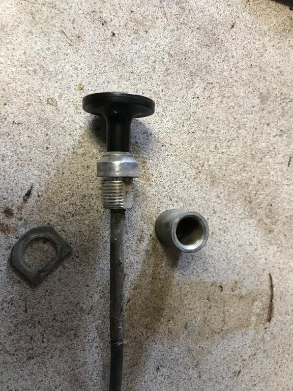

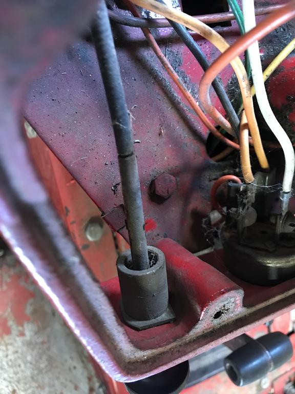

PeacemakerJack 11,096 #96 Posted November 15, 2019 I need some help fellow “horsemen” I need to install a different choke cable on Zach’s tractor. The original one is about 3” too short with the new motor in place. However, I don’t know how to remove this old one and I don’t want to wreck it... I can’t figure out how this is retaining to the dash. All the ones that I have dealt with in the past have a conventional nut on the back... Thanks 1 Share this post Link to post Share on other sites
Aldon 4,834 #97 Posted November 15, 2019 I’m pretty sure that the pipe looking piece is threaded and spun on but it’s been 5 years since I removed one so my memory may be fuzzy. 1 1 Share this post Link to post Share on other sites
Pullstart 71,561 #98 Posted November 15, 2019 If you can try to spin that pipe, I’d say go for it! Maybe the dash has a flat spot in it to prevent the cable housing from spinning... 1 1 Share this post Link to post Share on other sites
PeacemakerJack 11,096 #99 Posted November 15, 2019 Thanks Guys...your memory is still functioning Aldon😉 This is what the 1970 installed choke cable looks like. The little metal piece keeps the cable from spinning and the pipe is the “nut”. However, the hole in the dash is too large for the spare choke cable that I have. 1 Share this post Link to post Share on other sites
Aldon 4,834 #100 Posted November 15, 2019 Use bushing and washer 1 Share this post Link to post Share on other sites
