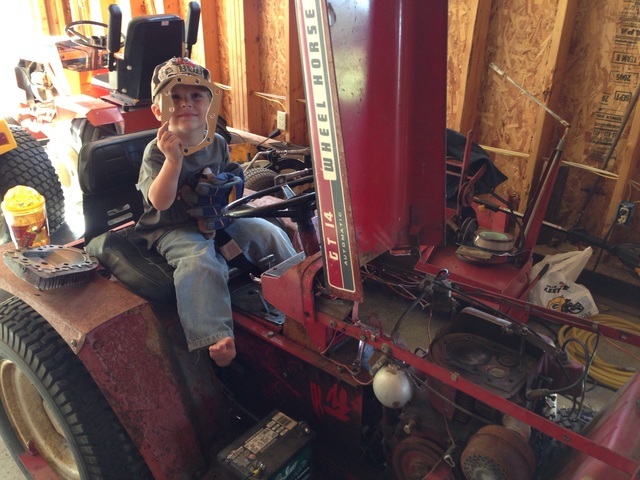

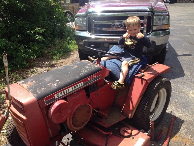

PeacemakerJack 11,061 #1 Posted July 2, 2016 Guys, I've been following Aldon's most recent restoration of his "GT-16" with great interest and he did an amazing job as usual. About two years ago I located a GT-14 locally that had the Cat O hitch and the WW-93 weights. Other than that, it was/is in really sad shape. I have four children and each has their own garden tractor. The idea being that when they are each about 14 years old we will do a complete tear down and restoration. This way each one of my children will receive a basic working knowledge of mechanical things, electrical things, painting, assembly and disassembly. Hopefully, it will also be a fun experience for them. In the mean time, we have workers that will be fun to make memories on and use to do the usual chores. Anyway, the old GT-14 was purchased with the thought that it would be my youngest son Zach's tractor. He just turned three and this year has been really bugging me about it. He loves all things mechanical and therefore is all about tractors. I know that that tractor would take a ton of work just to get going and it would be hard for me not to do a full restoration if I got started on it. All my other kids tractors are fully functional albeit not restored yet. My oldest and I will start his next year. So, Zach has been saying all summer, "that's my GT 14!!! Why can't we drive it?" What do I say to the cute little guy? "Because the engine smokes like a diesel under load, or because the hydro has leaked nearly a gallon of fluid while parked in the last two years, or because the electrical is totally screwed up"? Nothing would make sense to him at this age. He just knows that his tractor doesn't work!!! ENTER BLACKBEARD! Not unlike some of you, we name our tractors that we are going to keep in the family. This tractor came up for sale locally just a couple of days ago. It is model number 7452 serial number 724916. We bought it from a guy named Todd who was the son of the original owner. The tractor seems to be well cared for although the paint is pretty thin. It has a several items that need work before it can be run but it seemingly much closer than my existing tractor. The PTO gave out about five years ago on Todd's dad and looks to have fried the wiring in that circuit completely (I'd be open to comments about that possibility...). The fuel in the tank is stagnant but other than that it is in very ORIGINAL condition for being about 46 years old. It came with the original owners manuals for the tractor, deck, and snowthrower. It also came with an old 8" furrow plow which is missing multiple parts. Todd said that he grew up cutting and blowing on that tractor. His dad passed away a couple of years ago and his mom asked him to get the tractor and parts out of the garage. He didn't have time to fix it up so he sold it to us... Here Zach and Judge look at Blackbeard loaded up and ready to head home. Zach is a big fan of pirate movies and when we saw that non original black painted hood, that was the name that came to my mind... Here's Todd and Zach at the "transfer of ownership"! Zach is so excited about his new tractor he can hardly contain himself. So, my plan is to take the PTO clutch from my existing tractor and remove the items that I want to keep from it for Blackbeard. Then I'll be selling that as a parts or restore...so if any of you who are in close proximity to east central WI are interested all ready PM me. My first question is, "What helpful hints do you have for removing and reinstalling and setting up the PTO?" I want to make sure that I do it right! That's one happy little dude! He'll be able to grow up using a WH just like I did!!! 17 1 Share this post Link to post Share on other sites
SylvanLakeWH 32,504 #2 Posted July 2, 2016 Lucky kid and Dad!!! 4 1 Share this post Link to post Share on other sites
Aldon 4,832 #3 Posted July 2, 2016 (edited) Zachary looks stoked big time. It will be a great tractor for him. Lots of fellas on here to help you with the PTO. I'll chime in as well. But it I think the topics been covered. If no one chimes in, I'll see if I can find the thread and add a link to this thread sometime in next day or so. Laptop is easier for me than phone for such things. PS, I love the moniker! Edited July 2, 2016 by Aldon 3 Share this post Link to post Share on other sites
312Hydro 474 #4 Posted July 2, 2016 Great story and I see smiling faces all around! That's just a fantastic thing to share with your kids. I'm thinking a flag with the skull an crossbones would look good with it. Great find and the memories will be priceless. 3 Share this post Link to post Share on other sites
rmaynard 17,582 #5 Posted July 2, 2016 Don't get that GT-14 anywhere near me. If you know pirate history, Blackbeard met his demise at the hands of Lieutenant Robert Maynard. Oh by the way, nice tractor. 8 6 Share this post Link to post Share on other sites
SylvanLakeWH 32,504 #6 Posted July 2, 2016 15 minutes ago, rmaynard said: Don't get that GT-14 anywhere near me. If you know pirate history, Blackbeard met his demise at the hands of Lieutenant Robert Maynard. AAARRRGGGHHH! 3 Share this post Link to post Share on other sites
PeacemakerJack 11,061 #7 Posted July 2, 2016 13 minutes ago, rmaynard said: Don't get that GT-14 anywhere near me. If you know pirate history, Blackbeard met his demise at the hands of Lieutenant Robert Maynard. Oh by the way, nice tractor. Exactly! I was laughing about that as soon as I saw your avatar! Thanks guys for the thoughts. I'll keep posting pics, updates, and videos as we get it together! 312Hydro---I'm thinking of something That would tie in the Wheel Horse logo with the traditional pirate flag and have a decal made up for the seat back. That way when we are plowing at a plow day, the person behind is staring at that "banner" arrrrrrr...maties! 2 Share this post Link to post Share on other sites

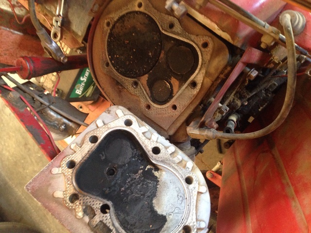

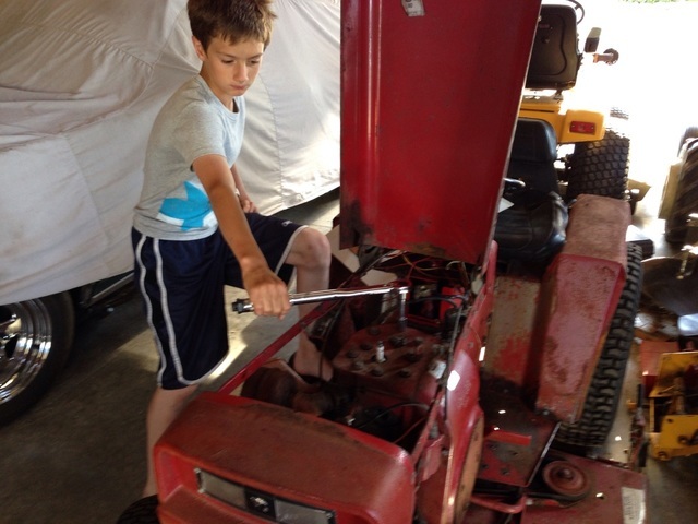

PeacemakerJack 11,061 #9 Posted July 3, 2016 A good day working on Blackbeard! I was able to remove the carb and clean it. The old float bowl had a thin spot that had opened just slightly. I didn't want to have the risk of that leaking later so I replaced it with another from my stash. I removed the old nasty fuel line and replaced it as well as the fuel filter. I function tested everything to the carb and I had fuel flow. Then I pulled the head... To say that it had carbon buildup was the understatement of the day! So I spent awhile cleaning that all up. I had a fresh gasket in my drawer and so I was ready to put it back together. Zach was keeping a close "eye" on the progress and must've asked me a hundred times today, "What's that?". He is so much fun to have around while doing a project like this, keeps me from getting to upset and forgetting the really important things of life! Caleb, my oldest, helped me install the head bolts and torque it to spec! He really is starting to get into this stuff more and more. I didn't have a replacement battery and so I hooked it to my car battery with jumper cables and fired it up after changing the oil and installing the new air cleaner. It had to turn over a little before it fired because of the fuel bowl being empty. However, it started and ran. It has a miss that I have to trouble shoot but he's ALIVE! It's a pirates life for us now! Look out Maynard, Edward Teach is looking for revenge! 8 Share this post Link to post Share on other sites
Don1977 606 #10 Posted July 3, 2016 It could be that the carburetor need cleaning. If that doesn't fix the miss check the valves. I had a bad miss with a 12 HP magnum found the intake valve way to tight. 3 Share this post Link to post Share on other sites
953 nut 69,301 #11 Posted July 3, 2016 8 hours ago, PeacemakerJack said: It has a miss that I have to trouble shoot In spite of your cleaning of the carburetor, there could be a minor deposit or two; use some Seafoam spray into the air intake (outdoors) and add Seafoam to the fuel. 8 hours ago, PeacemakerJack said: Zach was keeping a close "eye" on the progress and must've asked me a hundred times today, "What's that?". Father and son in the shop; best teaching method ever! 7 Share this post Link to post Share on other sites

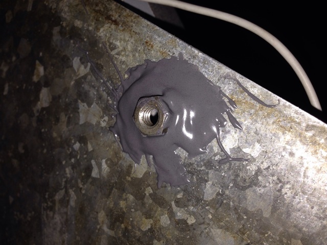

PeacemakerJack 11,061 #15 Posted July 6, 2016 Today after work my daughter helped me reattach the seat foam and cover to the pan. When I took the seat apart I was able to get the two side bolts out without incident. However, the center bolt snapped off. I fiddled with it for a couple of hours last night and finally managed tearing the nut out of the seat pan. So, I decided to place a washer on top of the pan and then a nut on that and epoxy the whole works together... I'm not sure how it will hold up but I think it should work pretty well for that application. Claudia and I were able to get the seat back together and it turned out really nice. I spent about 45 min removing the Cat O from my other GT-14 and then decided to take Zac for a ride on his tractor since he was already in the house and bathed when I was running it last night. It started right up and ran pretty smoothly. We drove it for about five minutes when it does just like someone turned off the key...! Any ideas??????????? later tonight I'll check to make sure the fuel pump is still functioning. The only other thing I can think of is the breaker less ignition. Since there are no points to check...I'd appreciate any thoughts you have. 1 Share this post Link to post Share on other sites

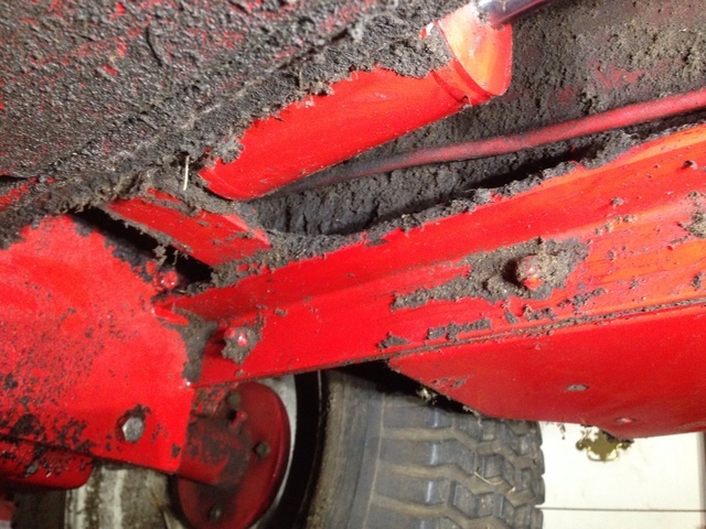

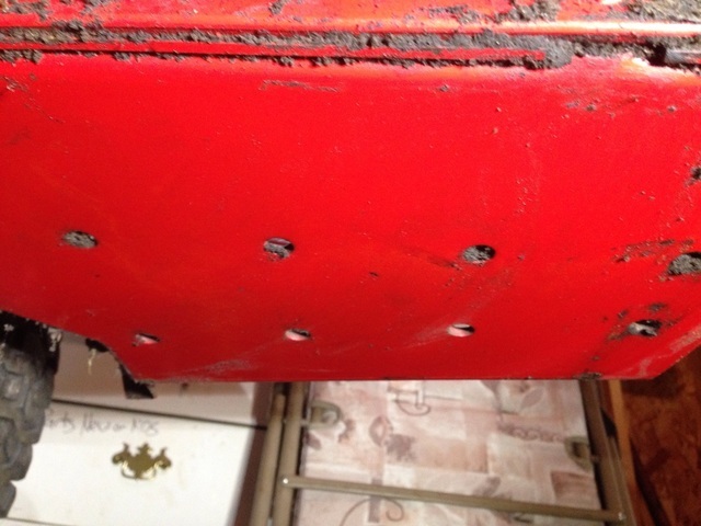

PeacemakerJack 11,061 #22 Posted July 26, 2016 On July 6, 2016 at 6:39 PM, PeacemakerJack said: ...We drove it for about five minutes when it does just like someone turned off the key...! Any ideas??????????? later tonight I'll check to make sure the fuel pump is still functioning... Sometimes it takes a fresh pair of eyes!!!!! Last night I had a long time friend over to my house to help me rebuild a Ross steering box for my sons CC 100. He worked for Chief equipment, the same farm implement dealer that my dad worked for. Pat was responsible for setting up the new Cub Cadets and repairing any GT's that came in needing servicing. He has that responsibility for about a decade and therefore became very familiar with the Kohler engines. I asked him if he would mind taking a look at Blackbeard. After playing with the carb adjustments for a minute or two, he pointed out that the piece on top of the throttle assembly was loose, real loose! He pushed that down where it should set and tightened the screw. Instantly the engine began to run much smoother. I'm not saying that the ignition system is completely glitch free yet. However, as we discussed that finding, I recalled hitting a fairly large bump both times that it killed out. It seems somewhat far fetched to think that a huge gulp of air would kill the engine that fast but Pat did say it was possible. He also said that much of the sputtering and missing was from the constant change in air/fuel ratio mixture... I'll you posted on that as updates warrant. For the mean time it is back to the refurbish. Next up, cleaning the tunnel area. Lots of caked on grease. I did note one thing after cleaning that area. This thing didn't spend too long outdoors. Look at the bottom side of the footrests... and the lift ram... It made me feel good to see this. I can paint to top side of the sheet metal and know that the undercarriage will be just fine until Zac and I do an official restore in about 10 years! 5 Share this post Link to post Share on other sites
Aldon 4,832 #23 Posted July 26, 2016 My symtoms were a bit different than yours but I too had a problem with carburetor top screw working loose continuously. I swapped it out rather than rebuild. I have 3-4 carbs sitting ready to be rebuilt. Figure that's a good winter project. The underside of the tractor does look well preserved. 3 Share this post Link to post Share on other sites
ztnoo 2,302 #24 Posted July 26, 2016 The underside of your GT 14 looks mighty good to me. Enough grease and oil mixed with dirt on a vehicle that was mostly inside during its lifetime, means it will likely be well preserved. What I see looks outstanding! A gentle and careful pressure washing might leave you shocked with how well preserved the tractor is. Amazing. Cleaning will also make working on it much easier. 3 Share this post Link to post Share on other sites
