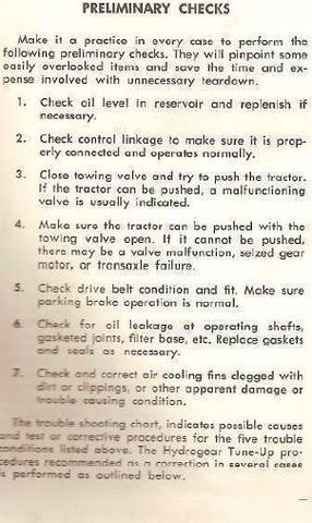

coldbear 29 #4 Posted July 1, 2016 Yes my tow valve is locked tight. I put on a new belt. I installed a new Wicks filter that crossed over from WH. My hydro pulley is not slipping on the shaft. I installed new trans fluids. Now that I'm out of options, I could use more repair ideas. Should I just buy a new pump?( seen one on Ebay for $100.00) and that's a bit much for me.) Love this Old Girl. No mower, just the bear bones for the grand children to ride on. Yes my tow valve is locked tight. I put on a new belt. I installed a new Wicks filter that crossed over from WH. My hydro pulley is not slipping on the shaft. I installed new trans fluids. Now that I'm out of options, I could use more repair ideas. Should I just buy a new pump?( seen one on Ebay for $100.00) and that's a bit much for me.) Love this Old Girl. No mower, just the bear bones for the grand children to ride on. I was wondering if someone in our WH club might have a rear end that would fit my unit?? If so, I'll forward a finders fee. cb. Share this post Link to post Share on other sites

pfrederi 18,784 #7 Posted July 1, 2016 There is not a lot of serviceability according to the old WH manuals on the Wheelamatic. The service manual is available here.http://www.wheelhorseforum.com/files/file/3312-transmission-hydro-sundstrand-wheel-a-matic-1969-sm-a-5179pdf/ The acceleration valvesa nd tow valve are about it. Picture shows teh checks tehy recommend before you tear in. Have you tried pushing it with tow valve closed? 1 Share this post Link to post Share on other sites
