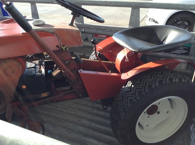

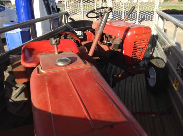

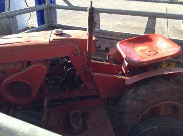

howell1000 35 #1 Posted June 30, 2016 went to detroit yesterday and had a couple horses follow me home a 753 and 702 . The 702 a guys budy just bought a big building found it under a bunch of trash and he was going to scap it so i saved it . The 753 the guy used it to pull a boat around at his house he sold the boat so he did not need the 753 he also gave me all new decals for it the 753 has two head lights on top of hood they are round glass i have them to dont know if factory or not all in all a good day 11 Share this post Link to post Share on other sites

russellmc301 601 #4 Posted June 30, 2016 that is going to need some pliers to steer the one. also love those costoms Share this post Link to post Share on other sites
howell1000 35 #5 Posted June 30, 2016 take a little work but worth it Share this post Link to post Share on other sites

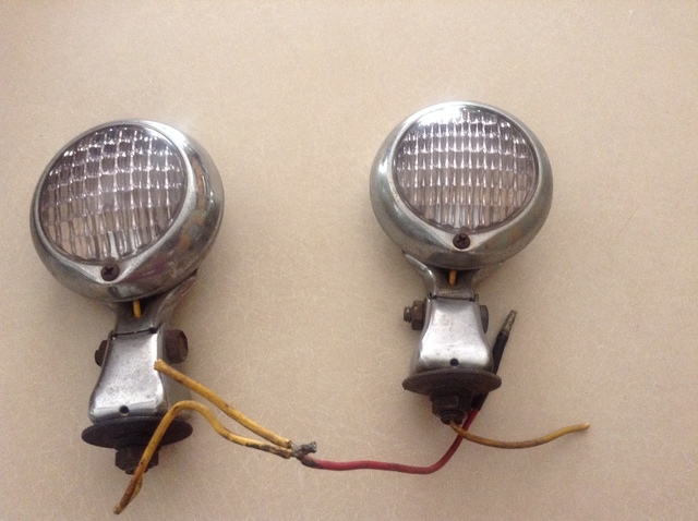

howell1000 35 #7 Posted June 30, 2016 i also got these an anyone tell me if they are after market or came with the wheel horse Share this post Link to post Share on other sites
AMC RULES 37,259 #8 Posted June 30, 2016 Aftermarket. Share this post Link to post Share on other sites

howell1000 35 #12 Posted July 1, 2016 (edited) the 753 has new tires and looks like he started to restore it it needs a 753 seat it has after market it needs little things here and there i need to find a good 753 mower deck to and were the bungie cords are holding the hood down looks like someone cut the holes out Edited July 1, 2016 by howell1000 more info Share this post Link to post Share on other sites

gawald 30 #14 Posted July 2, 2016 For the broken steering wheel, John Deere 200 series tractors (210, 212, 214, 216) use a 3/4" hole steering wheel with 1/4" roll pin hole which is the same as my C141 steering wheel. I bought the C141 with broken steering wheel just like your tractor. Wheel Horse steering wheels that I saw for sale cost half as much as my tractor and the cosmetics were poor. The 200 series steering wheels are 3 spoke and have the right wheel diameter and height. The plastic molding is different but both WH & Deere wheels were made by Kelch Corp. I got my Deere SW on eBay for $25 including shipping. Seems Deere 200 series parts are a lot more plentiful & thus cheaper price than WH. I like OEM parts when possible but will compromise with a non OEM part until an affordable original comes along (if ever). Great acquisitions. Congratulations. Share this post Link to post Share on other sites
