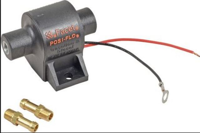

pfrederi 20,905 #6 Posted June 30, 2016 (edited) or try one of these. Facet 60245 posi-flow pump. about $33 I have installed 3...418A, C175-8 and C141. Eventually all my under seat tank horses will have them. No more eternal cranking when they have sat unused for a few weeks Edited June 30, 2016 by pfrederi 3 Share this post Link to post Share on other sites

scotty 252 #8 Posted June 30, 2016 I was thinking about the electric fuel pump too. Seems like a lot better system. 1 Share this post Link to post Share on other sites
pfrederi 20,905 #9 Posted June 30, 2016 Been getting mine from here http://www.aircraftspruce.com/catalog/eppages/solidstatepump.php 1 Share this post Link to post Share on other sites
scotty 252 #10 Posted June 30, 2016 Did you just wire it to the solenoid? Share this post Link to post Share on other sites
pfrederi 20,905 #11 Posted June 30, 2016 Just now, scotty said: Did you just wire it to the solenoid? I wire mine to the ignition or accessory terminal. Solenoid would be on all the time. 'My setup doesn't pump when it is cranking. Turn the switch on wait 2 seconds, it is enough to make sure the carb bowl is full then start her up. (You will hear the pump change sound when the float valve closes. 1 Share this post Link to post Share on other sites
Rob R 989 #12 Posted June 30, 2016 Just wondering what the best pressure range is when you decided to go the electric pump route..... I would assume lower is better (1-2 lbs pressure range) so as not to have any fuel perhaps getting into the oil pan.... I see fellow "wheelers" putting pumps in up to the 4 lb range and this sounds HIGH to me....I know my old Sears Suburban which has a weak pulse pump has a spring loaded needle valve to prevent over flow...... also since the electric pump would have to be "ON" the entire time the engine is running what effect if any would this have on your alternator and battery charging? Thanks Share this post Link to post Share on other sites
pfrederi 20,905 #13 Posted July 1, 2016 Current draw is negligible. Pressure range for this pump is 4pisi max. I bypass the Kohler pump so I won't be getting gas in the crankcase. Share this post Link to post Share on other sites
