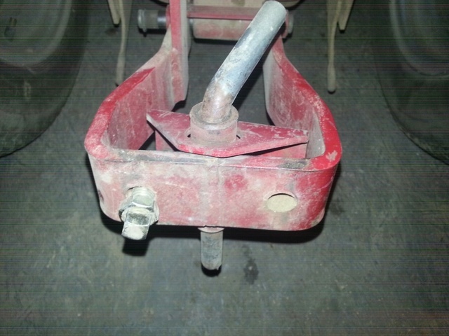

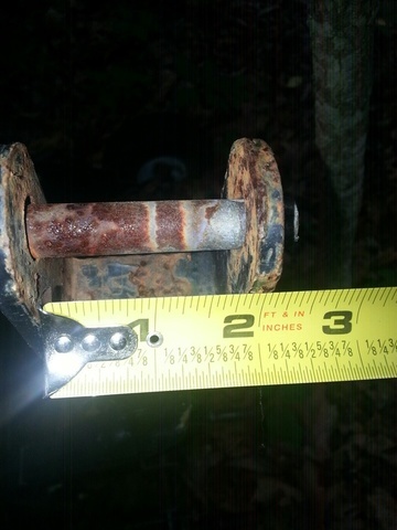

I am a novice and this does not add up. I bought a CL Craftsman Aerator and thought I could attach it directly to my clevis hitch, but the opening is to small on the aerator hitch.
What do I need to do in order to make this fit?
Will regular Brinly attachments fit directly on the clevis hitch?

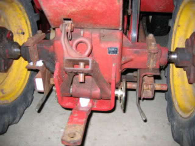

Yes, regular Brinly attachments fit the clevis hitch. What you need is called the tow hitch, or drawbar hitch depending on who you talk to.  It can be installed simultaneously with the clevis hitch, just like I have mine installed with my slot hitch in this old picture.
