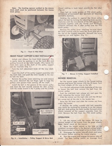

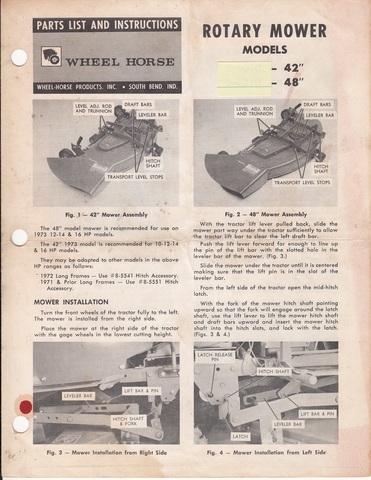

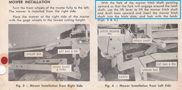

daveoman1966 3,883 #2 Posted June 29, 2016 (edited) Here is an IMPORTANT part of the hook-up. You gotta get this RIGHT, or the deck won't be connected correctly. I will post further details in a few minutes... Here are a few pages of info to help..... The hookup is the same for 36 42 and 48" decks....Hope this helps. Edited June 29, 2016 by daveoman1966 3 Share this post Link to post Share on other sites
WheelHorse-fan 3 #3 Posted June 30, 2016 Thanks thats a real help Share this post Link to post Share on other sites
