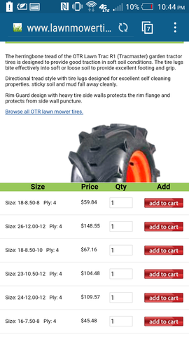

WVHillbilly520H 10,378 #6 Posted June 29, 2016 TSC has the HI RUN and sitting on the floor unmounted they measure 23" tall and lawnmowertires.com has OTR brand and I bought a used set of Nankang years ago other than dry cracked the tread has held up rather well mowing tilling and snow removal,Jeff. 1 Share this post Link to post Share on other sites

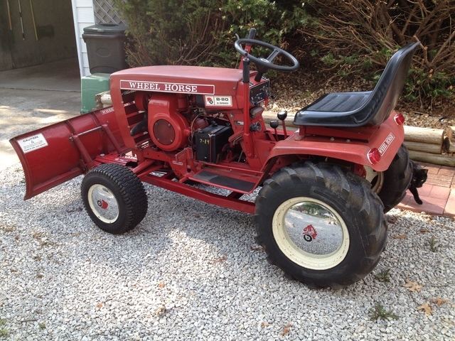

TDF5G 2,074 #9 Posted July 8, 2016 (edited) I have Carlise AGs on my B-80. Ran them for about 20 years now. Still in good shape. I bought them for better mowing traction on the hills in my yard. Edited July 8, 2016 by TDF5G 2 Share this post Link to post Share on other sites
WheelHorseNut 222 #10 Posted July 8, 2016 That looks great -- nice tractor! I just picked up a B-80 a few weekends ago. What size did you go with? They look like they really held up well, that's for sure! Share this post Link to post Share on other sites
TDF5G 2,074 #11 Posted July 8, 2016 7 minutes ago, WheelHorseNut said: That looks great -- nice tractor! I just picked up a B-80 a few weekends ago. What size did you go with? They look like they really held up well, that's for sure! Thank you. Those are 23X8.50-12. They have held up well. Used to push snow with it also until a couple of years ago. My drive is gravel, so it hardly ever gets run on pavement. Share this post Link to post Share on other sites
WheelHorseNut 222 #12 Posted July 8, 2016 Thanks very much for the info. Going to be using mine in the dirt a bit so I'm sure that will help. Thanks again! 1 Share this post Link to post Share on other sites
