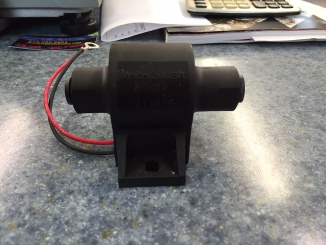

TimH 105 #10 Posted July 5, 2016 My local Toro dealer gad all the parts I needed except a fuel pump. Any one know were I could get a new pump or rebuild kit ? I am going to go ahead and do a valve job and re ring the engine while I have it removed and apart. Share this post Link to post Share on other sites
TimH 105 #11 Posted July 6, 2016 http://www.aircraftspruce.com/catalog/eppages/solidstatepump.php 1 Share this post Link to post Share on other sites
TimH 105 #12 Posted July 8, 2016 Just received new Electric fuel pump. I rebuilt engine and carb. new points and con. Runs like new now. 1 Share this post Link to post Share on other sites
elcamino/wheelhorse 9,363 #13 Posted July 8, 2016 Tim , Which pump ( part number ) did you order? Share this post Link to post Share on other sites
TimH 105 #14 Posted July 8, 2016 1 hour ago, elcamino/wheelhorse said: Tim , Which pump ( part number ) did you order? 60300n 05-06862 60300 Share this post Link to post Share on other sites
elcamino/wheelhorse 9,363 #15 Posted July 8, 2016 Thanks Tim for the information. 1 Share this post Link to post Share on other sites
