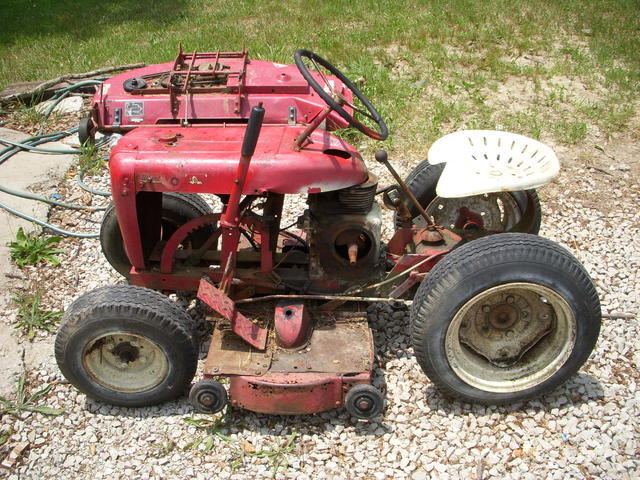

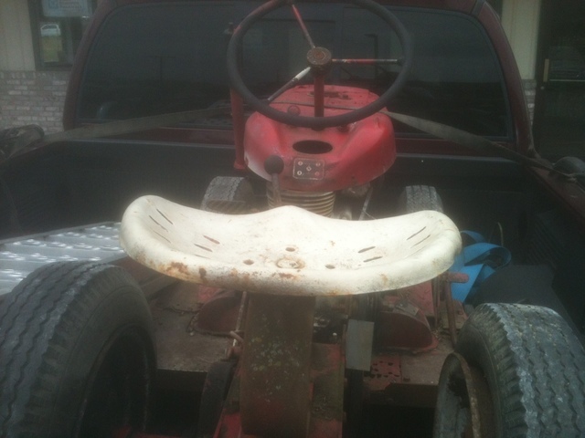

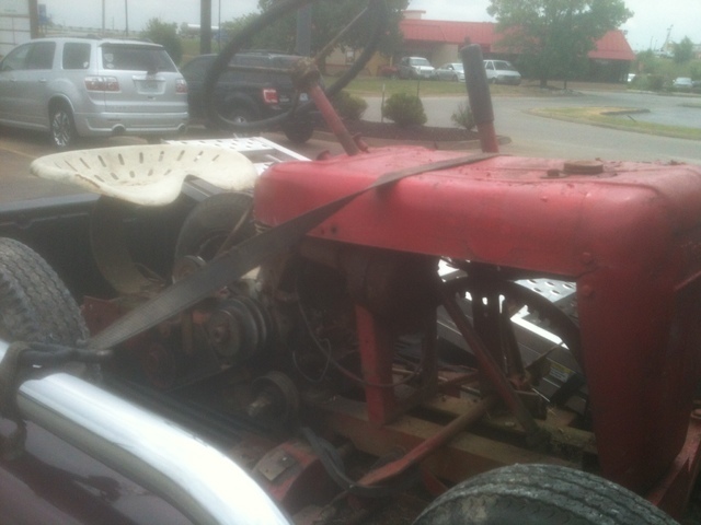

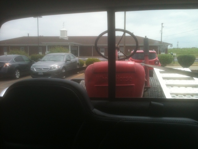

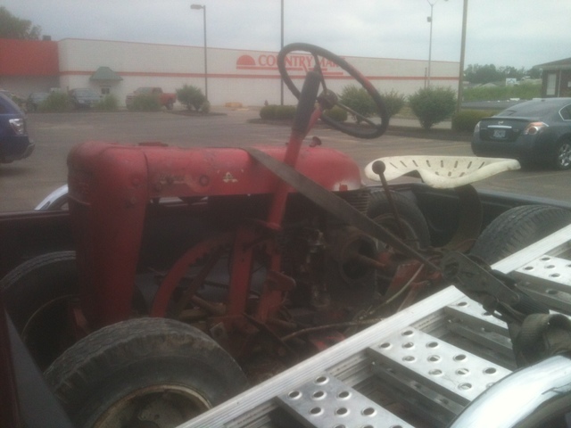

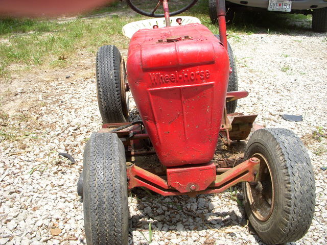

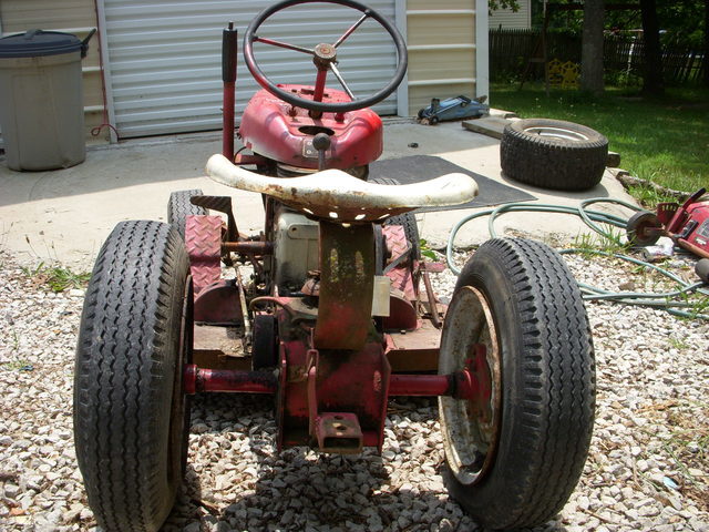

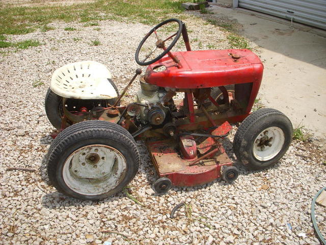

T-Mo-(Moderator) 4,752 #1 Posted June 23, 2016 Here is the $50 WH that was on ebay this past Saturday. Steve (wh500special) knew I was looking for one, so he grabbed it and then passed it on to me. I picked it up just now and it's sitting now in the garage with the 416-8 and some JDs. It's missing some engine pieces and the front wheels are bolted to hubs, incorrect rear wheels, and the deck is pretty shot, and I'm pretty sure the seat spring is backwards. But, it's safe and sound now. 8 Share this post Link to post Share on other sites

T-Mo-(Moderator) 4,752 #3 Posted June 23, 2016 Yeah, it's a project. It will probably get a Predator engine just so I can drive it around. This one is missing the flywheel, carburetor and who knows what else. I just took off the deck, and I can say for a certainty, that, and I don't want to offend anyone, but a JD deck is a lot easier than this one to remove. Share this post Link to post Share on other sites

ohiofarmer 3,383 #7 Posted June 23, 2016 So we have a new term for the deck. Perforated patina.. Anyway, good luck with the project 1 Share this post Link to post Share on other sites

wh500special 2,378 #9 Posted June 23, 2016 Doesn't look too bad for fifty bucks! I was glad to help in a small way. I figured if you didn't want it I could make good use of it! Might need to name that one "Festus," Terry! ive always wanted to do it but haven't yet, but I think replacing the original toasted motor on one of those with a Honda GC190 would be sweet. They don't have the slanted cylinder like the heavy duty GX series and are more compact. Not as tough, but good little engines. And pretty cheap too. Just an idea. steve Share this post Link to post Share on other sites
Achto 30,862 #10 Posted June 24, 2016 5 hours ago, T-Mo said: It will probably get a Predator engine just so I can drive it around. The 6.5hp Predator engine bolts right down in the existing frame holes, Down side is the air cleaner will only fit under the hood if you remove the top cover. The muffler does not fit under the hood either. I added a different air cleaner, down side made the brake hard to get to. Fixed that later by bolting a wrench on top of the brake peddle. Purchased an exhaust flange and bent 3/4" conduit to reach a muffler under the hood, no down side on that. After these alterations I had to drill the main jet out with a #67 drill bit. 2 Share this post Link to post Share on other sites

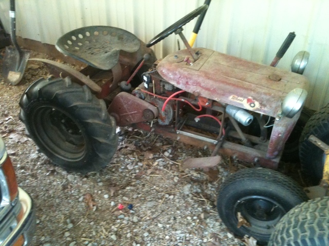

T-Mo-(Moderator) 4,752 #14 Posted June 24, 2016 The Horses might be reproducing. I was over at my friends house trying once again to talk him out of his Wheel Horse. He told me he probably sell it at one point, but wasn't ready yet. But when I showed him pictures of the ebay "Festus" 401, he may just let me have his. I think it's a '61 also. I'm thinking it's a Techy engine on it. Anyone can tell me if it's a 401 or maybe 551, or maybe a '60 something. Oh, and he has a 4 hp Kohler engine that I will be getting from him for the ebay "Festus" 401. 1 Share this post Link to post Share on other sites
Achto 30,862 #15 Posted June 24, 2016 That one is a 1961 judging by the hood and foot rests. 1960 had throttle and choke levers, 1961 had throttle and choke pull knobs. 1961 was also the only year for the style of foot rests in your picture above. If the Techy is the correct engine, I believe it to be a 551 with the electric start. The foot rests on Festus I believe are for a 1960 but the hood is a 61. 2 Share this post Link to post Share on other sites

whfan74 2,073 #17 Posted June 25, 2016 8 hours ago, T-Mo said: The Horses might be reproducing. I was over at my friends house trying once again to talk him out of his Wheel Horse. He told me he probably sell it at one point, but wasn't ready yet. But when I showed him pictures of the ebay "Festus" 401, he may just let me have his. I think it's a '61 also. I'm thinking it's a Techy engine on it. Anyone can tell me if it's a 401 or maybe 551, or maybe a '60 something. Oh, and he has a 4 hp Kohler engine that I will be getting from him for the ebay "Festus" 401. Yup it looks to be a 551! Hope the good luck keeps rolling your way. Share this post Link to post Share on other sites
