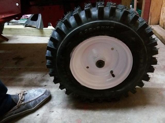

rhnEUMANN 0 #1 Posted June 22, 2016 (edited) Will size 16x6.5 - 8 fit Model 1-7041 Wheel Horse? Can't find the 16x5.50-8 which are on the parts list. Edited June 22, 2016 by rhnEUMANN Forgot item. Share this post Link to post Share on other sites
953 nut 65,121 #2 Posted June 22, 2016 They will be just fine, 16 is the outside diameter and 8 is the rim size. You probably won't even notice the extra inch of width. 2 Share this post Link to post Share on other sites
KC9KAS 4,746 #3 Posted June 22, 2016 @rhnEUMANN That is only 1/2" extra on each side of the wheel! 1 Share this post Link to post Share on other sites
SylvanLakeWH 31,031 #4 Posted June 23, 2016 5 hours ago, 953 nut said: They will be just fine, 16 is the outside diameter and 8 is the rim size. You probably won't even notice the extra inch of width. And Share this post Link to post Share on other sites
Tankman 3,528 #5 Posted June 23, 2016 Fit fine and look great. Share this post Link to post Share on other sites
mmmmmdonuts 274 #7 Posted June 23, 2016 (edited) For my Raider tires I went with the 4.8-8 tires instead of the 6.5. I like the change with the narrower rims. It makes steering seem tighter. Edited June 23, 2016 by mmmmmdonuts Share this post Link to post Share on other sites
