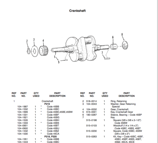

Do you have the service manual?
Is this the gear?

Macgyver
Yes I have that info. I have removed the clip & the fiber / plastic piece
but can't get gear to move. There are 2 10-32 tapped holes in the gear
But find it hard to believe that is how you pull it off.

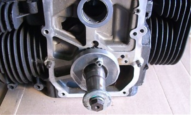

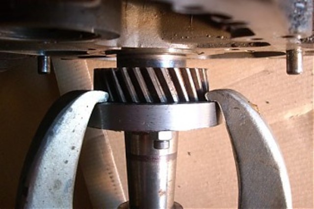

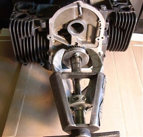

A few pics of my Onan gear pulling setup.
