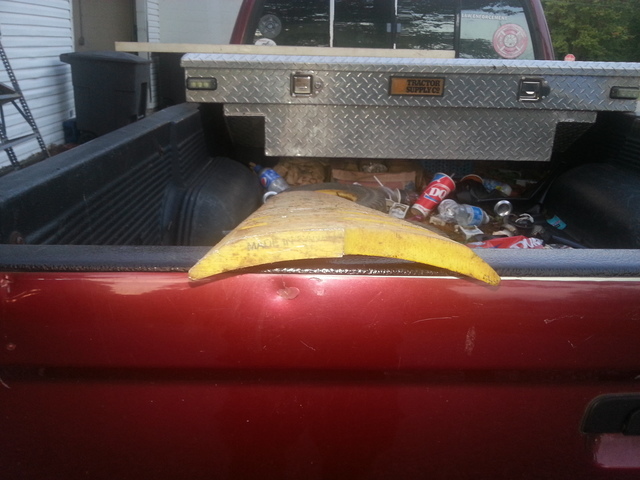

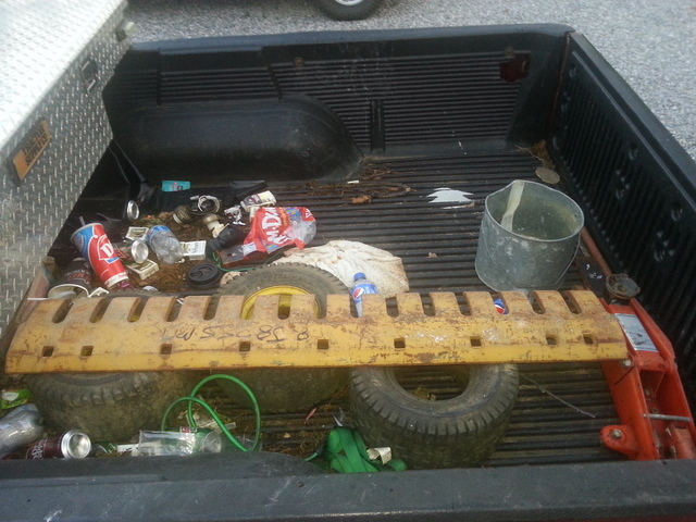

Nxt2doc 51 #1 Posted June 19, 2016 (edited) So here's the deal. While traveling back to the ambulance base from posting today I stopped by a buddies house to check in on him. Yes I was in my district and did not leave any area uncovered. It kind of a perk of the job. He recently had to find a new job due to down sizing and all. He works on mine equipment as a mechanic in our area. So he has some odds and ends laying around his shop that followed him home from the dumpsters at the mine's. He had two blade cutting edges that fit what I assume was a dozer blade. Long and short of it I ended up with one in the cabinet with the oxygen cylinder for the ride to the base and eventually the back of my truck. My idea is to make a rear mounted grader blade out of it for my 1267. Want to be able to flip it from toothed edge to flat edge so it will have to bolt to its carrier. My question is with it weighing in at about 60 lbs. is it going to be too much for a sleeve hitch. I'm thinking of only extending it about 18 inches out from the hitch. Thank you all for any and all reply's Here's a couple of pics. Don't pat attention to the junk pile in the truck. Edited June 19, 2016 by Nxt2doc 2 Share this post Link to post Share on other sites
Lane Ranger 10,495 #2 Posted June 19, 2016 (edited) Heavy duty -this should make a good grader blade -no doubt about it! Sleeve hitch and cable should be good for at lease 200 lbs of wright Edited June 19, 2016 by Lane Ranger Share this post Link to post Share on other sites
squonk 38,948 #3 Posted June 19, 2016 Hitch will handle it. Mechanical advantage as it to pertains to lifting it is the issue. There isn't a lot of leverage associated with the average Horse lifting system. I have seen some busted bell cranks and twisted hood stands as the result. That's one reason the 300 and up series tractors started having provisions for the rear rockshaft to lift the heavy stuff like tiller's ect. Share this post Link to post Share on other sites
cheesegrader 433 #4 Posted June 20, 2016 I use a brinley box blade for to clear debris from ditches, and for the final pass on my gravel drives. Weighs about 70 lbs, and I usually add another 50 to level the gravel. Mine is on the back of a 520 with a clevis hitch, and it is no problem. Your blade is much sturdier, and could probably do the work without added weight. Be careful to check cable routing. I have seen some reports of lift cables digging into transmission housings. 1 Share this post Link to post Share on other sites
