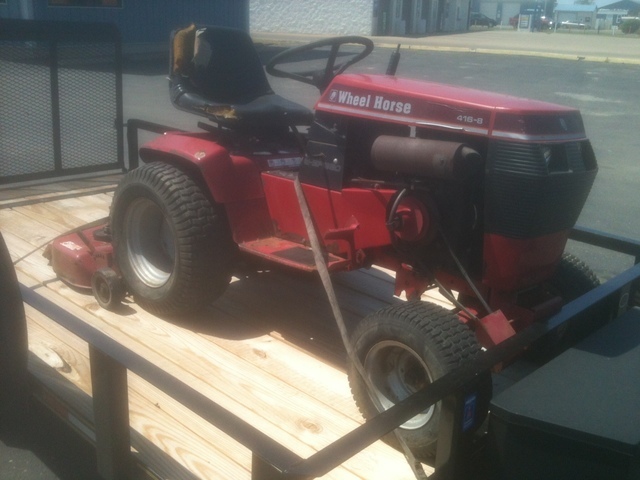

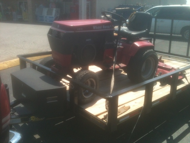

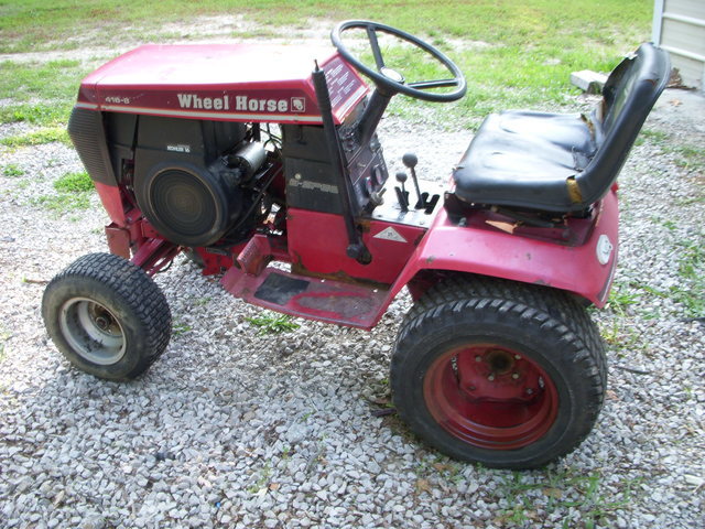

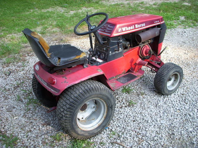

T-Mo-(Moderator) 4,855 #1 Posted June 18, 2016 (edited) Runs and drives good. Needs the steering looked at, it pops when you turn the wheel. Left rear tire is shot and needs replacing. I might replace both back tires with some ags. Deck needs blades and a spindle. I might restore this or leave it alone as is and just fix what's wrong. Oh, and it will get a new seat. Per the id plate, it's a 1988. BTW, sorry for the lousy, blurry, dark photos. My iPhone is almost as old as this tractor. Edited June 18, 2016 by T-Mo 12 Share this post Link to post Share on other sites

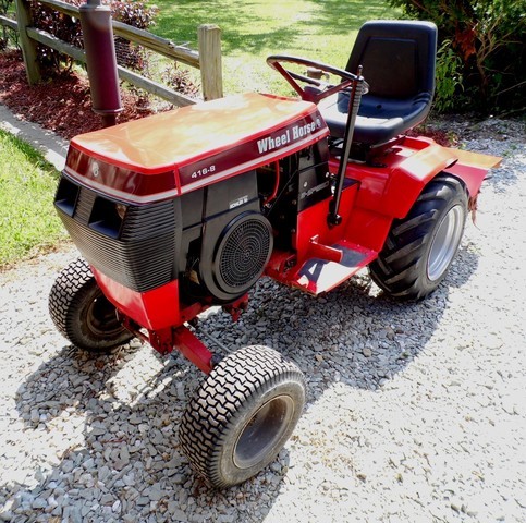

Molon_Labe 731 #6 Posted June 19, 2016 Nice find, especially with the Kohler Magnum. Here's a pic of my 416-8 with an ASC seat with the correct bolt pattern. LINK 6 Share this post Link to post Share on other sites

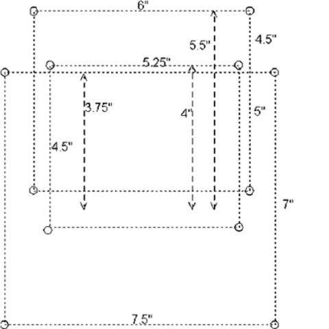

Tankman 3,528 #8 Posted June 19, 2016 (edited) The seats, on the shelf at Tractor Supply work fine. Bolt pattern matches is correct, pan is steel. http://www.tractorsupply.com/tsc/product/high-back-mower-seat-black?cm_vc=-10005 The way the rubberized seat cover just stretches over the seat, easy to remove and replace. The foam can be easily removed and replaced. Drill and mount the seat pan as required, replace foam and seat cover. I did this to one seat sometime ago. Was simply enough. Bolt Patterns (width x depth) 6" x 5" 7.5" x 3" 7.5" x 7" 8.2" x 5" 8.5" x 1.63" 11.25" x 11" Edited June 20, 2016 by Tankman 1 Share this post Link to post Share on other sites

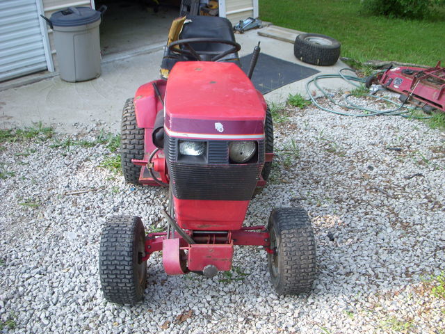

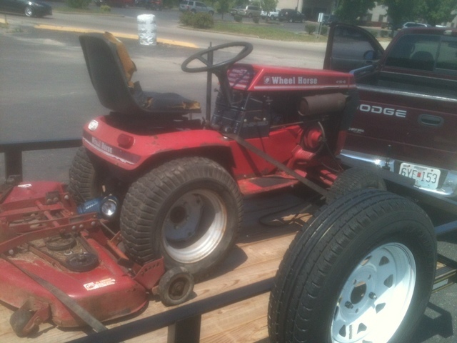

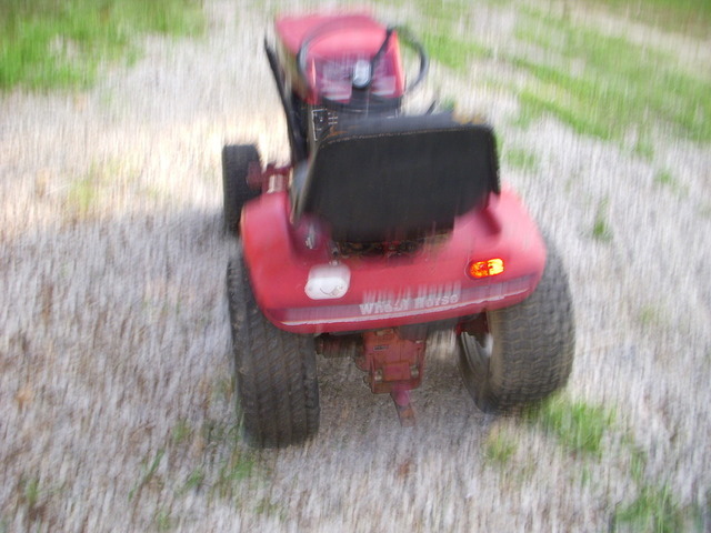

T-Mo-(Moderator) 4,855 #10 Posted June 19, 2016 I went out this morning and took more pictures. I put on an old tire and rim that I had lying around since the one wouldn't hold air for more than a few seconds. One thing I noticed is that the lift mechanism doesn't seem to be working right, I have to look at that. Also, that round headlight has to go. 2 Share this post Link to post Share on other sites
rjg854 13,093 #11 Posted June 19, 2016 round headlight has gotta go Share this post Link to post Share on other sites

T-Mo-(Moderator) 4,855 #13 Posted June 20, 2016 22 hours ago, Molon_Labe said: Nice find, especially with the Kohler Magnum. Here's a pic of my 416-8 with an ASC seat with the correct bolt pattern. LINK Looking at the bolt pattern on that seat, I don't think it will fit. I measured the bolt pattern on my seat and it's 7.5 inches from side to side and 8 inches front to back. I don't see that in this seat's bolt pattern drawing. Share this post Link to post Share on other sites
wallfish 20,053 #14 Posted June 20, 2016 Original style seat. Bolt pattern should be close enough to make it work. Thinking mine has slots in the mount but can't really remember. http://www.surpluscenter.com/Brands/Seat-Solutions/135-DELUXE-HIGH-BACK-BLACK-SEAT-1-3202-BK.axd Mounting Bolt Pattern (Width x Depth) 6" x 5" 7-1/2" x 3" 7-1/2" x 7" 8-1/4" x 5" 8-1/2" x 1-5/8" 11-1/4" x 11" Share this post Link to post Share on other sites

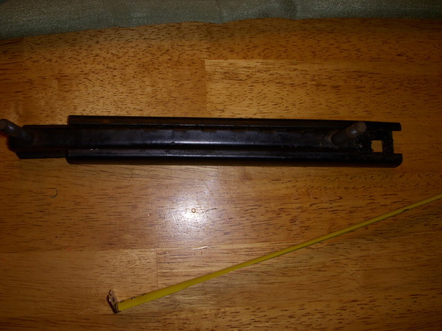

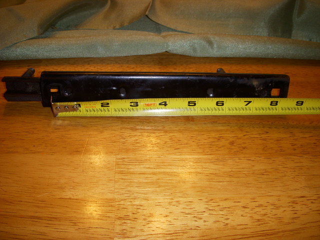

T-Mo-(Moderator) 4,855 #15 Posted June 20, 2016 I pull off the track that the seat bolts to. The square holes is where the seat bolts to. As you can see, the distance between those square holes is 8 inches. So, I would have to drill new holes to accommodate anything less than 8 inches. The track will only go so far in from each end, so I might get 7 inches if I drill a half inch in from each hole, but that would be about all I could go in. The slots is on the other part of the bracket where the long bolts in the tracks bolt to. So, there is no slots to accommodate anything less than 8 inches unless new holes are drill. Share this post Link to post Share on other sites

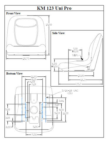

rmaynard 17,247 #16 Posted June 20, 2016 The seat that I put on my 416 was a KM-123. Here is the link. The bolt pattern on the bottom has the configuration that you need. http://www.tractorseats.com/p-110593-km-123-uni-pro-bucket-seat.aspx 2 Share this post Link to post Share on other sites
