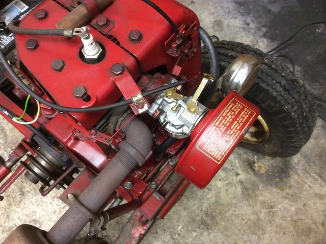

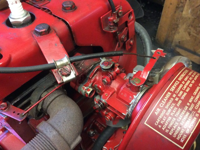

Live4outdoors 151 #1 Posted June 18, 2016 Here we are days from big show, I've rebuilt the carb twice, had a small engine shop go over my work and I have a bad running 653,. I know everyone raves on these Chinese carbs but there are too many h60 replacements available and none look even close to mine. I can have one by Tuesday off amazon and ready for the big show but not sure which one is right. Thanks all. Share this post Link to post Share on other sites

Live4outdoors 151 #3 Posted June 18, 2016 All the replacements have the real high choke lever and mine is flat. I saw your earlier post about your good luck but not sure what to use and now outta time...LOL like always Share this post Link to post Share on other sites
oldredrider 2,553 #4 Posted June 18, 2016 Just change out the choke shafts. I do it all the time and works like a charm. 2 Share this post Link to post Share on other sites
Live4outdoors 151 #5 Posted June 18, 2016 Great, never dreamed they would interchange, going to order now then thank you! Share this post Link to post Share on other sites
wallfish 18,430 #6 Posted June 19, 2016 Or just simply bend that bracket holding the conduit up a little. If needed you can also bend the choke lever down a little too. 3 Share this post Link to post Share on other sites
AMC RULES 37,221 #7 Posted June 19, 2016 (edited) Just bent the new carbs choke lever down, where it needed to be... to match up the angle of the original. No sweat at all. Edited June 19, 2016 by AMC RULES 1 Share this post Link to post Share on other sites
Live4outdoors 151 #8 Posted June 22, 2016 Thanks all! Got it running again, still a little temperamental but the best she's ever run, spent an hour fine tuning the best I can get it! 3 Share this post Link to post Share on other sites
