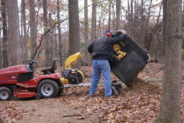

cgambino1018 28 #1 Posted June 18, 2016 (edited) Gentlemen, I have a 312 1988/89 with a 42inch deck and I use a Cyclone Rake in the back that I connect to the bagger brackets. It works awesome! On my single acre I only have to dump the clippings twice. The problem I have is when the cyclone bag fills it gets heavy and its very easy to pull the front wheels off the ground. What can I do to get more weight on the front end. As a side note, I do have a bracket connected to the mule drive that I connect a thatcher to once a year. I am pretty sure I should not put weights on this but just wanted to let you know. All comments and feedback are appreciated. Edited June 18, 2016 by cgambino1018 5 Share this post Link to post Share on other sites

shallowwatersailor 3,221 #7 Posted June 18, 2016 I think that part of the problem is that the hitch is too high and shifting weight quicker to the rear. It needs to be semi-rigid to transfer weight to the tractor. I have the XL 415 gallon-size on the rear of my 5xi and use a 2" receiver hitch to attach mine. It sometimes does get a bit light depending on the density of the leaves if I fill it until it blows out the relief. I would try and add weight to the thatcher bracket, weight the tires or add weight to the side of the frame like tractors used for pulling, and lower the hitch. Share this post Link to post Share on other sites
rmaynard 17,433 #8 Posted June 18, 2016 I have never had any problem with my cyclone rake lifting the front end of the tractor off the ground. I use the standard hitch provided by Cyclone which keeps the frame of unit level. When the bag is empty, the weight of the engine forces the hitch down slightly. But when the bag gets full, the center of gravity remains over the Cyclones wheels, thereby keeping the front of my tractor on the ground. Share this post Link to post Share on other sites
SPINJIM 1,997 #9 Posted June 19, 2016 How about moving the wheels on the Cyclone farther forward on the under carriage to carry more of the weight. The engine on the Rake, combined with the leaves, puts a lot of weight on the tow hitch. Also, as has also been suggested, find a way to mount the hitch lower, closer to the height of the WH rear axles. Good luck. Come this Fall, I'm going to wish I had a Cyclone Rake. Nice. Jim Share this post Link to post Share on other sites
cheesegrader 436 #10 Posted June 20, 2016 I agree with Jim, that moving the hitch closer to the rear axle of the tractor would reduce leverage of a loaded trailer. Lower or farther forward, or both. Just closer to the axle. Moving the trailer wheels forward would help, too. That might make moving an empty trailer clumsy, with the tongue up in the air. You will only get about 50 lbs of weight on the front wheels, and they are pricey. Loading the wheels won't add much more, since volume is so low. Easiest solution is probably adding weight to the front. Why do you think those brackets would suffer if you add weight? Share this post Link to post Share on other sites
