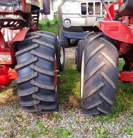

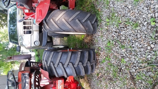

prondzy 3,890 #6 Posted June 19, 2016 For the money you can't beat the deestones, but to show here is my firestone flotations (left) vs deestones (right) They are both 23x10.5-12 Share this post Link to post Share on other sites
Uncle Buck 246 #8 Posted June 20, 2016 To my eye the Deestones look better, but that is just me. Share this post Link to post Share on other sites

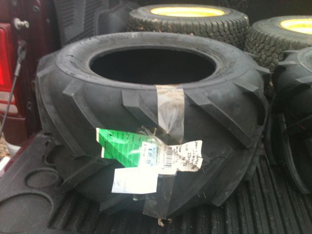

T-Mo-(Moderator) 4,928 #9 Posted June 20, 2016 Deestones will run a bit smaller in diameter than say Carlisle Tru-Power. TSC carries Hi-Run tires that are made in New Zealand from the molds from Carlisle. But, they're 2 ply, but I bought two sets of them and they're pretty good. They're the same diameter as the Carlisles, so they're bigger than the Deestones. http://www.tractorsupply.com/tsc/product/hi-run-wd1054-23-x-1050-12-in-2-ply-replacement-tire?cm_vc=-10005 Share this post Link to post Share on other sites

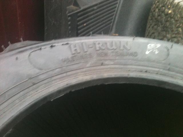

T-Mo-(Moderator) 4,928 #13 Posted June 20, 2016 (edited) My Hi-Run tires says made in New Zealand right on the tire. Edited June 20, 2016 by T-Mo 3 Share this post Link to post Share on other sites
