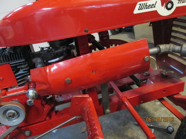

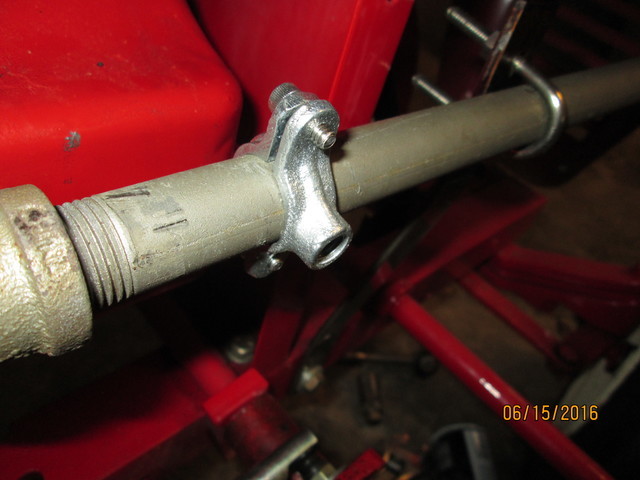

857 horse 2,588 #1 Posted June 16, 2016 I have had an original heat shield for a while now,,,,,, Then i had a thought..... it dont rattle,,,it dont slide down.... Call in now.....your thoughts welcome But you must call now....operators are standing buy Oh and my 401 in its winter skinneys 6 Share this post Link to post Share on other sites
dells68 7,499 #2 Posted June 16, 2016 Awesome. I'm doing something very similar for my son's suburban. I picked up a couple of ground clamps like you use to ground a wire to a water line to use (type with "teeth" to grab the pipe. 3 Share this post Link to post Share on other sites

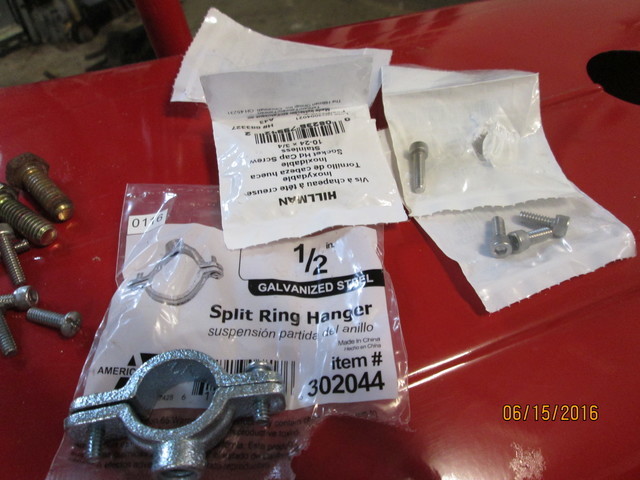

857 horse 2,588 #3 Posted June 16, 2016 6 hours ago, dells68 said: Awesome. I'm doing something very similar for my son's suburban. I picked up a couple of ground clamps like you use to ground a wire to a water line to use (type with "teeth" to grab the pipe. Dell,,,i saw these at Lowes,,,i dont even remember seeing these in a building....i had to change the little screws,,i couldnt get a screwdriver behind it....so I used small socket head screws....works great... Now i have to give her a good cleaning 1 Share this post Link to post Share on other sites
953 nut 70,330 #4 Posted June 16, 2016 That sure beats the old broom handle clips. Don't have to remember to take it off when traveling so it won't fall off. 3 Share this post Link to post Share on other sites
dells68 7,499 #5 Posted June 16, 2016 Only problem I had was that I had to open up the holes a little for the screws. Share this post Link to post Share on other sites
857 horse 2,588 #6 Posted June 16, 2016 9 hours ago, dells68 said: Only problem I had was that I had to open up the holes a little for the screws. Dell,,,,,,,,,,,,,,,same here....bigger holes,,,but,,,,im ok with it !!!!!! 12 hours ago, 953 nut said: That sure beats the old broom handle clips. Don't have to remember to take it off when traveling so it won't fall off. Richard,,,,,,,,that was the problem !!!!!! falling off..... 1 Share this post Link to post Share on other sites
