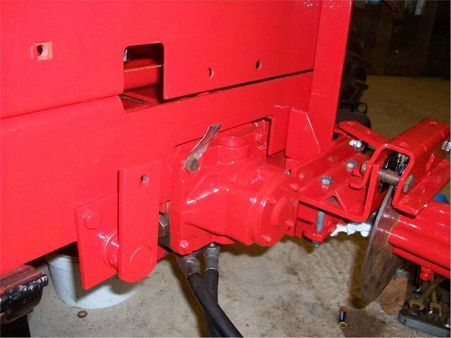

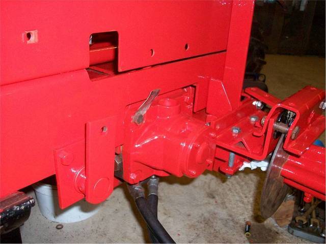

WHX?? 58,323 #7 Posted June 16, 2016 What is the dual hub set up you have goin on there?, Is that a disc for a brake Ithere?? .... .... I'm gonna need more pictures of that! 1 Share this post Link to post Share on other sites
pfrederi 21,274 #8 Posted June 16, 2016 Not sure about the dual hub but those are the optional turning brake discs. 2 Share this post Link to post Share on other sites
Phatboy 566 #9 Posted June 16, 2016 I really like thos wheel hubs,, it looks lke they go onto the axel deeper (or more of the axel goes inside them) s that true ? Or is that a optical illusion ,,, 1 Share this post Link to post Share on other sites
pfrederi 21,274 #10 Posted June 17, 2016 D series (including 18 autos) hubs are much deeper than regular horses...makes removing them very difficult if they are stuck on. 5 Share this post Link to post Share on other sites
WHX?? 58,323 #11 Posted June 17, 2016 Looks like they can be stubborn! I suppose that a good thing sometimes for these bigger horses & the work they do. Wondering what 23 Auto had to do to extend those axles. Custom make some? 1 Share this post Link to post Share on other sites
wheeledhorseman 579 #12 Posted June 17, 2016 10 hours ago, pfrederi said: D series (including 18 autos) hubs are much deeper than regular horses...makes removing them very difficult if they are stuck on. If you are thinking that Paul's puller arrangement looks like overkill I can say from personal experience with my D-200 it is not! If you use a puller with arms round the flange or a puller that bolts into the wheel nut threads on the flange you will either break the flange or strip out the threads. Yes, these hubs get stuck on that tight! The disc turning brake option mentioned earlier can be seen in this photo: Andy 1 Share this post Link to post Share on other sites
"D"- Man 827 #13 Posted June 17, 2016 This is a magnet that separateted from the cap, as you can see the material is hard, and broke away clean. On a side note, these are axles that were made from 4041 shafts that were magnetic induction hardened to 54 or 60 Rockwell hardness at the bearing areas. A fellow Redsquare member made these and shipped them to me. These are extra long for dual rear hub mounting to accommodate two 15" x 7" wheels per axle. 4 Share this post Link to post Share on other sites
