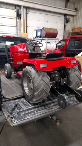

TIGman 2,006 #1 Posted June 11, 2016 Now guys sometimes I have some high level"Government Jobs" to weld on.... The Foreman's pulling tractor. I welded up the exhaust pipes, aluminum gas tank, etc. Please forgive the brand name on the tractor, but it is the right color and has a 25 hp Kohler twin in it. 7 Share this post Link to post Share on other sites
TIGman 2,006 #2 Posted June 11, 2016 The next tractor he builds I'll buy him a set of Wheel Horse decals !!!! 4 Share this post Link to post Share on other sites

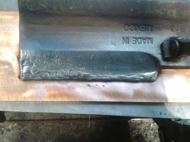

TIGman 2,006 #9 Posted June 13, 2016 1 hour ago, WHX61/3 said: Is a nice lookin puller tho & Cases aren't the worst...better than a JD ... sounds to me like you are sucking up to the boss! Would you believe I have to weld up the cutting edge on the shop owners lawnmower and brush hog blades so he can resharpen them..... . Share this post Link to post Share on other sites
AMC RULES 37,260 #10 Posted June 13, 2016 Well yeah...you want to get paid don't you? 2 Share this post Link to post Share on other sites
TIGman 2,006 #11 Posted June 14, 2016 After all this time, I'm finally figuring out that when you are a Welder you are everybody's friend. lol Share this post Link to post Share on other sites

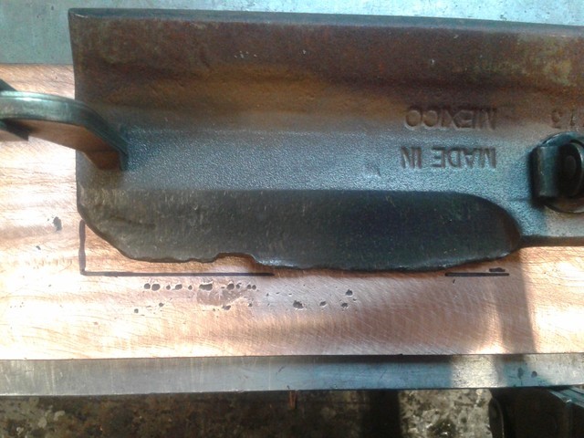

ACman 7,746 #12 Posted June 15, 2016 People look like I'm crazy when I tell them I used to weld in the nicks and corners of the blades before sharpening. 1 Share this post Link to post Share on other sites
TIGman 2,006 #13 Posted June 16, 2016 On 6/15/2016 at 11:39 AM, ACman said: People look like I'm crazy when I tell them I used to weld in the nicks and corners of the blades before sharpening. I plan on doing that on the blades for the 875. Will tell you a welding tip, I clamp the blade down on a piece of copper plate and then TIG weld the edge. Weld on the copper side turns out flat. . Those are the owner's Brush Hog blades!! lol 3 Share this post Link to post Share on other sites
