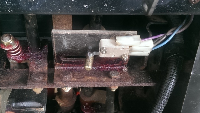

WVHillbilly520H 10,378 #3 Posted June 10, 2016 Check all your safety/interlock switches my most recent 520 sat outside most of its life the actuators on the PTO and/or Clutch/Neutral micro switches could be missing that was the issue I ran into while getting this one ready to now this past month,P.O. had jumpered the starter to the ignition switch bypassing the broken neutral switch instead of replacing the culprit of a no start issue, essentially the switch was good but wasn't working without the missing actuator,Jeff. Share this post Link to post Share on other sites

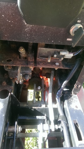

WVHillbilly520H 10,378 #6 Posted June 11, 2016 Just take a moment and look at my pics 1st one as I was taking it apart to clean and get a general idea of how bad things may be I didn't even notice the actuator was missing then about 2 weeks in to it all circuits "checked" out but for the life of me I couldn't figure out why it wouldn't start without the jumper wire from switch to starter solenoid, finally after getting frustrated one day I had the wire off then pushed the pin in on the microswitch and it attempted to turn over, looked that part up online and sure enough the actuator was missing so I replaced it and all it fine for now...my point is always check the simple things first fuses switches connections ect then worry about replacing parts...you say you replaced the ignition switch be very careful because although they look and fit the same some of those just don't work with the TORO/ONAN combo or with electronic spark ignition vs points/magneto ignition some of the posts aren't in the correct orientation could be causing your continuous starter running issues,Jeff. Share this post Link to post Share on other sites
