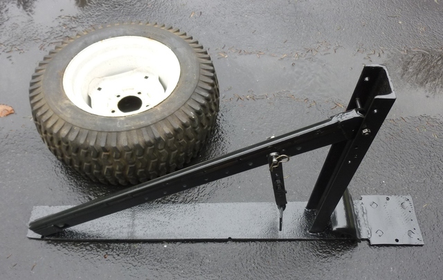

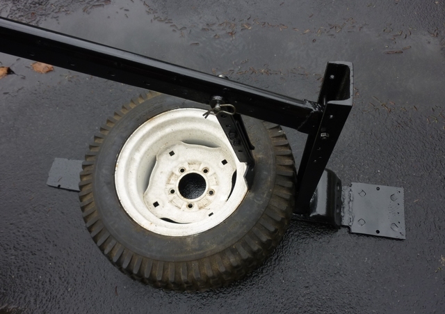

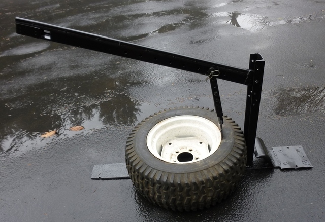

82Caddy 851 #9 Posted June 10, 2016 I use one of those attached to a 2in receiver hitch on one of my tractors or the truck. It works well and I've done 10+ tires with it now without issue. 5 Share this post Link to post Share on other sites

Rob R 989 #14 Posted June 10, 2016 Made one out of scrap iron and old garage door runners..... works like a charm. 14 Share this post Link to post Share on other sites
