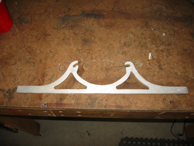

pfrederi 20,999 #42 Posted August 30, 2016 The harmonic balancer puller should work. Impact wrench will usually get the flywheel bolt with out a strap wrench. Torquing it back on is another matter. B&S has a tool that jams the flywheel by hooking on 2 fins. (see picture) Before I had a strap wrench I did what Kohler says you shouldn't do wedged something in the fins to torque it and never had a problem. I would absolutely not try wedging the fins for the loosening process. If the nut is corroded you will develop much more force trying to break it free than the recommend torque and you may break a fin. Strap wrenches are a lot cheaper than flywheels. 1 Share this post Link to post Share on other sites

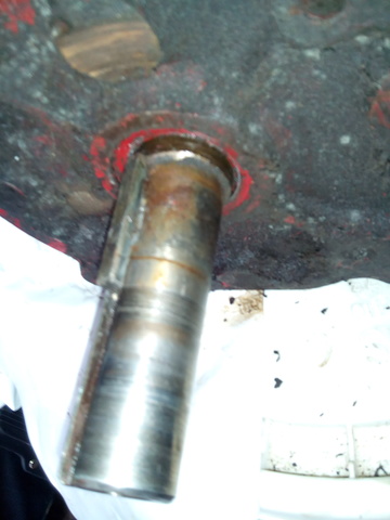

Sokniw 13 #44 Posted September 4, 2016 Alright i need help, i am having issues getting my cranskshaft out there is this slide guide on the crankshaft i cant get out and im trying to avoid damaging the bearing in there, i might have already. how do you get that groved guide out of the crankshaft so it will get passed the bearing. Share this post Link to post Share on other sites
pfrederi 20,999 #45 Posted September 4, 2016 It is 1/4" straight key sitting in a keyway. Soak it with PB Blaster or Kroil Then try vice grips to rock it out. If no go try hitting the end of the key with a punch don't drive it into the block but the keyway should be tapered up at the end and then the key should start to move up a bit then try agan with the vice grips. 1 Share this post Link to post Share on other sites
