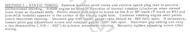

Howie 900 #6 Posted June 21, 2016 Timing is controled by point gap on the Kohlers. Share this post Link to post Share on other sites
953 nut 68,180 #7 Posted June 21, 2016 Kohler static_timing.pdf Share this post Link to post Share on other sites
Sokniw 13 #8 Posted June 21, 2016 Would and could this just make it not want to start at all? or do you think it would still try to spit and spudder even if the timing was that far off. Share this post Link to post Share on other sites

pfrederi 20,999 #14 Posted June 23, 2016 (edited) Turn the engine over slowly and see when the points open relative to the position of the timing mark on the flywheel. This is the mag timing instruction but battery/points is same procedure Edited June 23, 2016 by pfrederi Share this post Link to post Share on other sites
Sokniw 13 #15 Posted June 24, 2016 I will give it a go this weekend and see how i fair out. thanks Share this post Link to post Share on other sites
Sokniw 13 #16 Posted June 25, 2016 I can't seem to find the S through the timing hole, i found the t but no s Share this post Link to post Share on other sites
Thisguyisnew 114 #17 Posted June 25, 2016 Have to 16hp engine never did find those mark on either of them and had to resort to paint stick. I was told with spark plug out roll engine around by hand with finger over hole. When you feel the most pressure is the spot. Might even help you locate mark too Share this post Link to post Share on other sites
Thisguyisnew 114 #18 Posted June 25, 2016 I went by just when the breaker started to open and seemed to work fi Share this post Link to post Share on other sites
