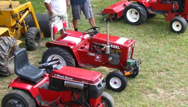

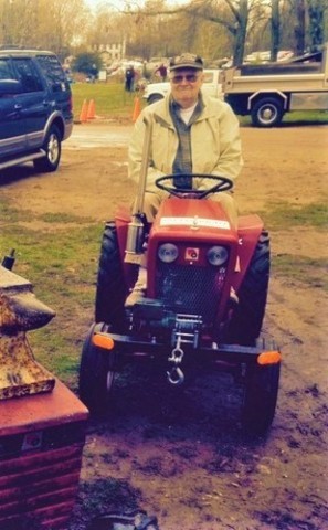

SALTYWRIGHT 861 #7 Posted June 10, 2016 I WILL HAVE MY 1054 DIESEL AT THE BIG SHOW ON FRIDAY. I DID NOT HAVE TO CUT THE HOOD. RUSS 1 Share this post Link to post Share on other sites

SylvanLakeWH 32,783 #11 Posted June 11, 2016 I will be watching this thread as I am thinking diesel down the road as well... Hey Saltywright - just curious - how Is that winch mounted? I've got a small one and I'm struggling with a mount that won't get in the way of the front mule drive on my c-105... Share this post Link to post Share on other sites
SALTYWRIGHT 861 #12 Posted June 11, 2016 CRAIG THANKS FOR POSTING THE PITURES. THE 1054 HOOD DOES NOT OPEN LIKE YOUR C-81. I MADE THE MOUNT FOR THE WINCH. RUSS 2 Share this post Link to post Share on other sites
