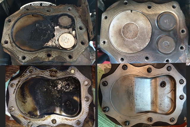

Al C. 1,480 #1 Posted June 9, 2016 A couple weeks ago I cleaned the cylinder head on my K341. This is the first time I opened it up. It was pretty dirty. I noticed a notch on the top of the piston head after I cleaned it. Can anyone tell me if this is a problem? Picture attached. Appreciate anyone's viewpoint. Share this post Link to post Share on other sites
Wishin4a416 2,610 #2 Posted June 10, 2016 (edited) Not a problem. Notch to the flywheel side when installing piston. Thats the way they went together. Edited June 10, 2016 by Wishin4a416 2 Share this post Link to post Share on other sites
KC9KAS 4,746 #3 Posted June 10, 2016 No problem...It designates the direction it need to be installed. Share this post Link to post Share on other sites
