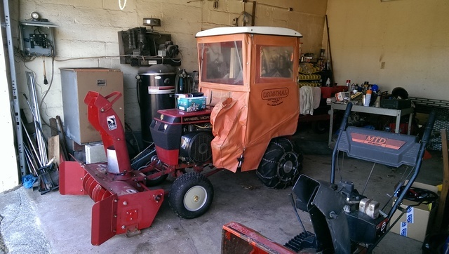

wallfish 20,572 #15 Posted June 9, 2016 5 hours ago, RICH FRO said: If you hear of any good snowblowers in the CT. area please pass it on to me. After you buy a tractor let me know, I have one that I put an electric motor on to control the chute. I use a larger 2 stage blower now and this is a backup but doubt I'll need it anytime soon. Was thinking of taking it to sell at the big show in two weeks but would prefer to sell it locally and not transport it down there. 1 Share this post Link to post Share on other sites

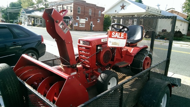

WVHillbilly520H 10,379 #20 Posted June 9, 2016 A couple pics....My 520 with single tall chute ,then with 2stage ,then 2stage actually blowing snow ,and the fact a C160 can handle a 2stage,Jeff. 5 Share this post Link to post Share on other sites
userj8670 68 #21 Posted June 9, 2016 So minus the shaker plate one is really not better or more heavy duty/desirable than the other (c160 vs161)? 2 hours ago, WVHillbilly520H said: A couple pics....My 520 with single tall chute ,then with 2stage ,then 2stage actually blowing snow ,and the fact a C160 can handle a 2stage,Jeff. I'm gonna go out on a limb and say that's not your c160 that's currently for sale by any chance? 1 Share this post Link to post Share on other sites
WVHillbilly520H 10,379 #22 Posted June 9, 2016 7 minutes ago, userj8670 said: I'm gonna go out on a limb and say that's not your c160 that's currently for sale by any chance? Sorry no it's not , it was a tractor I was looking into getting mostly for the 2stage and missed it by 1 day (I think it sold for $1600)...anyway I found my 2stage a year later for $250 so I reckon I didn't lose out on anything,Jeff. 1 Share this post Link to post Share on other sites
