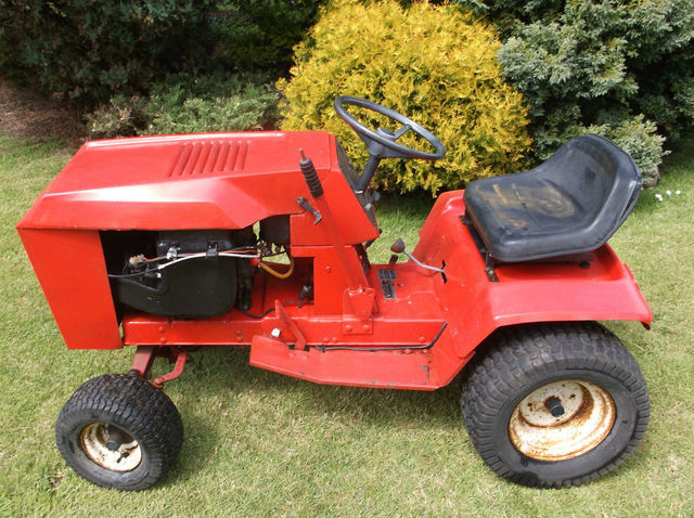

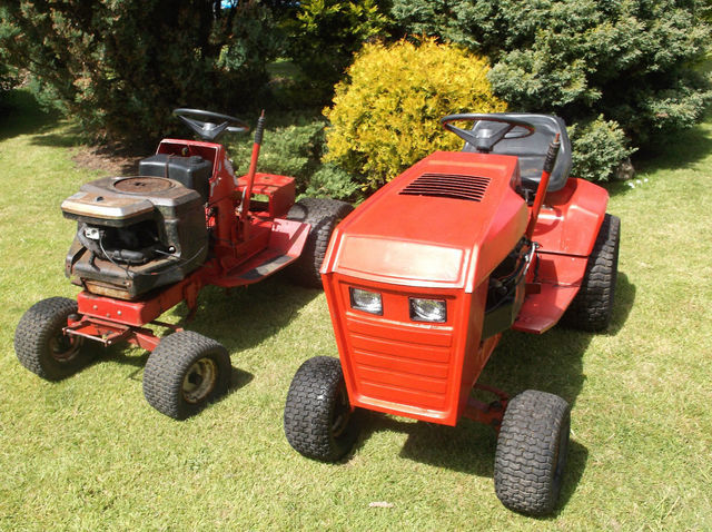

joejacko111 0 #1 Posted June 9, 2016 Hi Guys, Im needing a bit of help identifying the model, Wondering if anyone can help me Share this post Link to post Share on other sites
wallfish 20,733 #2 Posted June 9, 2016 I'm predicting B-165. Those look like 16 HP Briggs engines. Look for a tag with a model# to narrow it down. B165 with a 5 speed were 1981 -83 Share this post Link to post Share on other sites

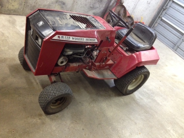

TDF5G 2,074 #3 Posted June 10, 2016 I can't identify the engine, but the tractor looks like my '82 B-115 Five Speed. Share this post Link to post Share on other sites

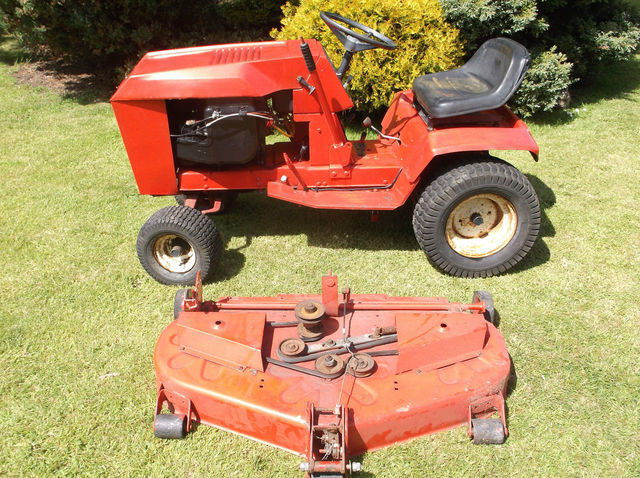

joejacko111 0 #4 Posted June 13, 2016 HI, Thanks for that, Looking at the spec etc, i think it is the B-115. Just a little confusing as its had a new engine cover added and a new paint job. The electrics are goosed. Does anyone know where i could pick up a new wiring harness for it. Also, Would you happen to know the size of belt used to drive the cutting deck? I have 2 different sizes, One is too tight n jams up the PTO clutch (1050 circumference) and the other is too slack, Thanks for the help! Share this post Link to post Share on other sites
gwest_ca-(File Mod) 12,533 #5 Posted June 13, 2016 There was a change to the original 41.29" (1050.8 mm) belt. It went to 41" (1041.4 mm) in service bulletin #361 Look through these http://www.wheelhorseforum.com/search/?&q="42xr01"&type=downloads_file http://www.wheelhorseforum.com/search/?&q="42xr02"&type=downloads_file http://www.wheelhorseforum.com/search/?&q="42xr03"&type=downloads_file http://www.wheelhorseforum.com/search/?&q="42xr04"&type=downloads_file http://www.wheelhorseforum.com/search/?&q="42xr05"&type=downloads_file http://www.wheelhorseforum.com/search/?&q="42xr06"&type=downloads_file 1 Share this post Link to post Share on other sites
