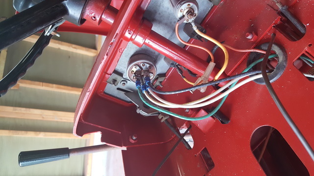

nickj21 20 #1 Posted June 8, 2016 Ran into some problems with my charger 12 resto. I redid all the wiring and now nothing happens when i turn the key over...i did one wire at a time making sure it was right..now somethings wrong and i cant figure out what..thanks for the help!! Share this post Link to post Share on other sites

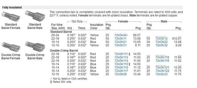

pfrederi 20,999 #3 Posted June 8, 2016 (edited) Time to get out the multimeter. Do you have voltage at the B terminal on the switch? Note be very careful testing, you really should use fully insulated connectors on the back of the switch. It would be easy to touch 2 terminals at once and if you have a breakeless ignition system you could fry some expensive parts. Edited June 8, 2016 by pfrederi 1 Share this post Link to post Share on other sites
Racinbob 13,087 #4 Posted June 8, 2016 It's pretty hard to figure out what's wrong without seeing it. First, as Mike said, check the ammeter if it has one. Then, with a meter or test light take it one step at a time following the wiring diagram. What year is the tractor so you are working off the correct diagram. 1 Share this post Link to post Share on other sites
