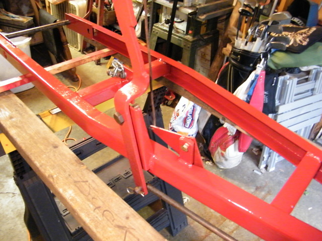

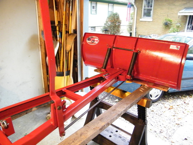

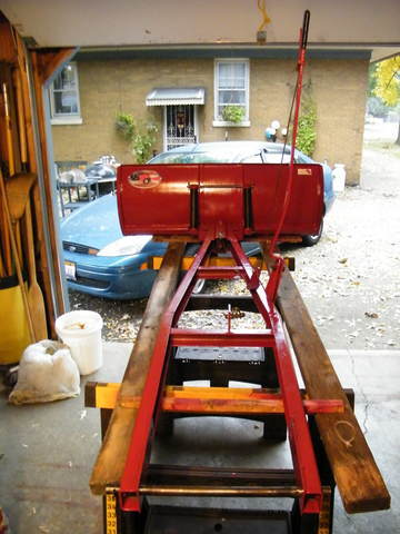

stevasaurus 23,884 #7 Posted June 6, 2016 It will attach to a bracket that is like an attach-a-matic that is attached to your rear axle at the end and the lift handle in the middle. BTW, Welcome to Red Square Your snow blade will look like this.. 7 Share this post Link to post Share on other sites

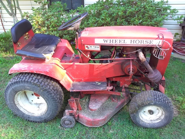

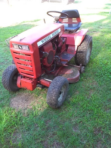

Thatoneguy 197 #14 Posted June 6, 2016 Here are a couple pictures of it. I had it all cleaned up but i take my daughter riding on it every evening and she just loves it! Thank for all the help everyone! I hope to have a collection one day as big as some of the people on here do!! 7 Share this post Link to post Share on other sites

buffaloman 295 #23 Posted June 7, 2016 (edited) I like the cup holder but it seems a little to far to reach, I figure its for coffee since its above the muffler to keep it warmed. Edited June 7, 2016 by buffaloman 2 Share this post Link to post Share on other sites
Thatoneguy 197 #24 Posted June 7, 2016 It just rattled down. I used that at camp to hold my brewskie!! I put some foam in it for shake resistant! I mowed 4 hours!!! Whew i was whipped! 4 Share this post Link to post Share on other sites
