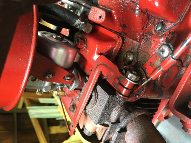

Aldon 4,833 #2 Posted June 6, 2016 post a pic of the throttle cable connection to the carb. You or the prior owner may have Governor bypassed. 2 Share this post Link to post Share on other sites
ryanmfairbank 26 #3 Posted June 6, 2016 Most likely the previous owner if that's the case... (not sure why it's posting the pic upside down! lol...it's not upside down on my cell, and it won't allow me to edit it) If this isn't a good angle, let me know... 1 Share this post Link to post Share on other sites
Achto 32,791 #4 Posted June 6, 2016 I do know that without the extended arm on the governor wheel there is not a lot of throttle travel. Where your cable is connected right to the gov. wheel, some have a little arm extending out from that wheel to increase cable travel. The cable hook up on my K181 is the same as yours, I have to pull on the throttle real slow to find a mid range speed. With my pull type throttle there is 3/8" or less travel. 1 Share this post Link to post Share on other sites

Achto 32,791 #6 Posted June 6, 2016 I see wear on your gov arm by the lower hole, was the linkage in the lower hole before? Further out on this arm will affect the throttle response to the gov. 3 Share this post Link to post Share on other sites
ryanmfairbank 26 #7 Posted June 6, 2016 It may have been...I will have to move it and see...but I don't think that little of an adjustment will resolve my problem... When I'm running the motor and find a decent throttle position in first gear, the motor nearly stalls when I engage the PTO...then, when I find the appropriate throttle position with the PTO engaged and I disengage it, the motor is revving way way high!?? Share this post Link to post Share on other sites

Achto 32,791 #11 Posted June 7, 2016 If the linkage was in the lower hole with the old carb and now in the upper hole with the new one this could be the change that is giving you trouble. The gov arm does not have to move much to open and close the butterfly on the carb. The further away from the pivot point on the gov arm you get the more travel you will get. 2 Share this post Link to post Share on other sites
wrightorchid 261 #12 Posted June 7, 2016 i always take pics of the linkage and holes, so I get them back in the correct place. The holes are usually worn where it was, but sometimes a challenge. 1 Share this post Link to post Share on other sites
ryanmfairbank 26 #13 Posted June 7, 2016 Yes sir...that was the problem...I didn't think that would make that much of a difference, but she is running good now! Thanks guys!!! 3 Share this post Link to post Share on other sites
