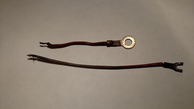

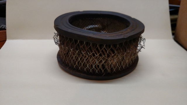

TIGman 2,006 #1 Posted June 5, 2016 Today I did a inspection of most of the electrical connections to find out most if not all were in bad shape. Hard to see, but all wire ends were white/green with corrosion. Some wires pulled out of connectors with little pressure. So started making up all new wires. Also did a little check on the Kohler K181S. Pulled the air cleaner apart to discover that someone used a little muscle putting the cover on. lol Going to be a fun project for me, can't wait to show more progress in photos. Share this post Link to post Share on other sites

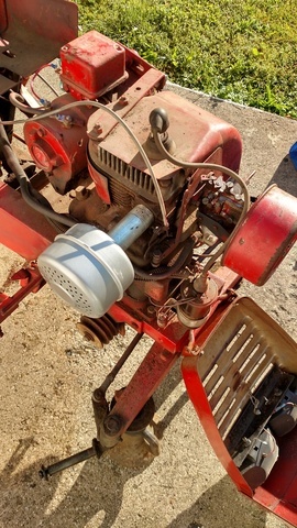

TIGman 2,006 #5 Posted June 7, 2016 Made some more forward progress tonight after work. Finished hooking up all the new electrical connections,new battery cables. Turned the ignition key and the starter and motor turned over. . No spark yet but I have to check out the rest of the electrical yet. And the slot hitch is moving more freely today. Still using the ATF fluid/Nexgen penetrating oil "Witches Brew" on it. It is working!!! . Friday could not move the hitch with a 36" pipe wrench... 1 Share this post Link to post Share on other sites
