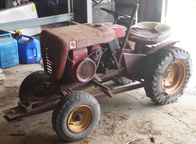

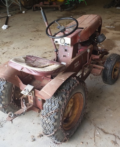

Jack45 69 #1 Posted June 5, 2016 My father-in-law has been storing a WH for me for about 10 years. My dad dropped it off at my FILs a long time ago and I never had a chance to pick it up. My steering gear went out (three broken teeth) on my Suburban so I went to my FIL's to pick up the one there in the hopes I could get parts off it. I was expecting a Suburban or RJ based on what my Dad had previously shown me. I got this instead. I am going to pick up a battery at the hardware store tomorrow and change the oil. It looks to be complete but I am pretty new at this. I am definitely looking forward to the electric start if it works. It has a K161 motor. Serial Number is 62-7158 Any other info is appreciated. 16 Share this post Link to post Share on other sites

prondzy 3,889 #3 Posted June 5, 2016 Very nice 702 you have there! 1 Share this post Link to post Share on other sites
953 nut 65,180 #4 Posted June 5, 2016 (edited) You are on your way to being a Round Hood master, herd is growing, next you need an RJ. Edited June 5, 2016 by 953 nut 3 Share this post Link to post Share on other sites
SylvanLakeWH 31,051 #5 Posted June 5, 2016 Nice tractor - better price!!! 2 Share this post Link to post Share on other sites
Retired Wrencher 6,574 #6 Posted June 5, 2016 Jack45 It is time the old girl came out of the dark and back into service. A good clean up and see where you are with everything. Enjoy. 2 Share this post Link to post Share on other sites
Jack45 69 #7 Posted June 5, 2016 Everything works on my little farm. I need it running so I can plow my next corn patch. This one is a little rusty but it is only surface rust. I will wire brush it and wipe down with a little oil and she will be good to go. Big concern is getting the engine going. Share this post Link to post Share on other sites
stevasaurus 23,662 #8 Posted June 5, 2016 Nice surprise there. Mine is 62-4216. It looks like you are just missing the guard over the engine/starter belt. 2 Share this post Link to post Share on other sites

coldbear 29 #10 Posted June 5, 2016 If I were you, I'd get the thing running and not touch a thing. Keep it stock and people will come. A very nice father in law if I might say. 2 Share this post Link to post Share on other sites
RedRanger 1,470 #11 Posted June 5, 2016 NO WIRE BRUSH!!!! Wash and oil rub. 2 Share this post Link to post Share on other sites
953 nut 65,180 #12 Posted June 5, 2016 Steel Wool and WD40. Share this post Link to post Share on other sites
coldbear 29 #13 Posted June 5, 2016 It's only original once. I don't know what it is about rust and well worn parts that attract gear heads? I think it's the mystique that we all had remembering what they looked like new on the showroom floors. Get it running mechanically and pull the kids around your little farm in a wagon. That's for your kicks and giggles. (: 1 Share this post Link to post Share on other sites
