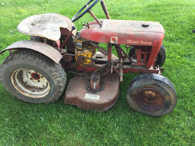

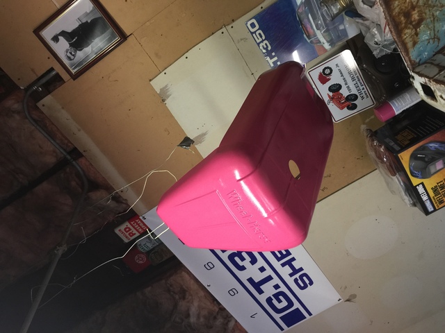

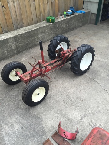

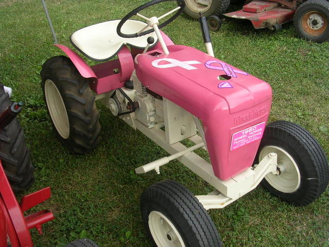

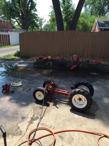

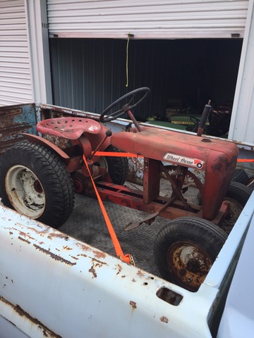

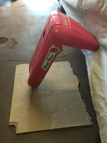

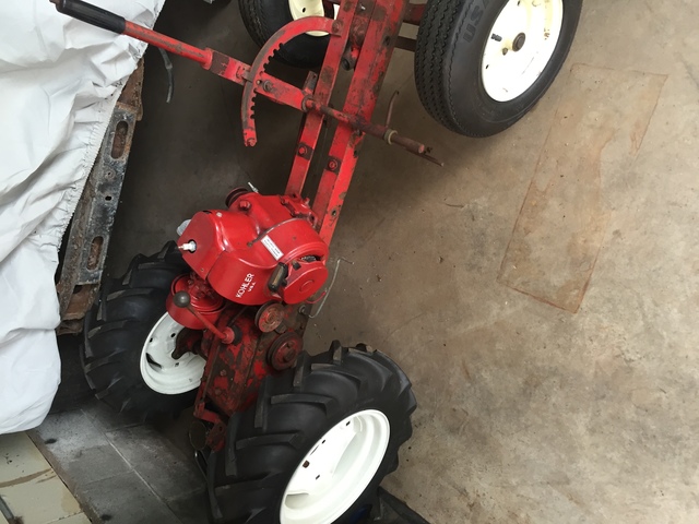

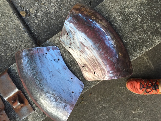

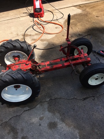

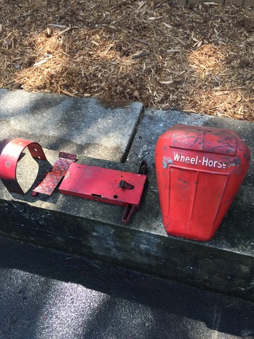

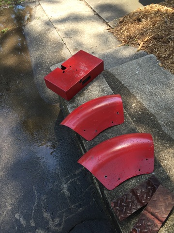

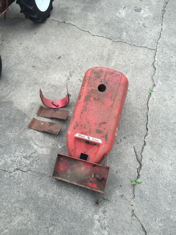

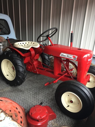

AlwaysLookin80 1,308 #1 Posted June 4, 2016 I restored a 400 last year for myself and now my daughter wants a pink one for the local show here. I have 6 and figured I could sacrifice one to be pink. Here's the start of the project. First picture is how I picked it up. We got it apart and the parts That will be pink are on the ground, I have the fenders and tool box too. Those will be pink. Frame and everything else will be tan or black. Looking to make something like the pink one in another picture. Last picture is of my 400 I did last year but it got to cold to paint the engine. They will be done for the local show in July. I'll post progress as I go. 12 Share this post Link to post Share on other sites

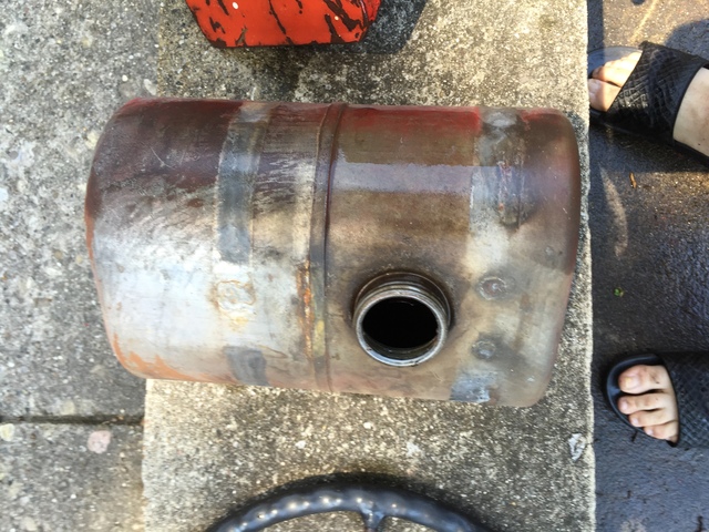

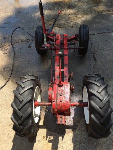

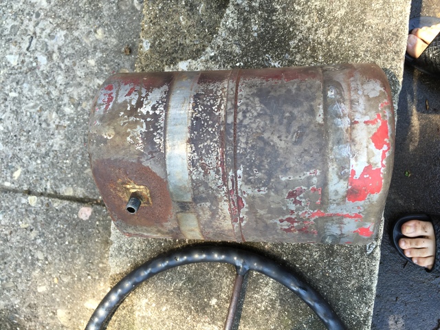

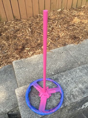

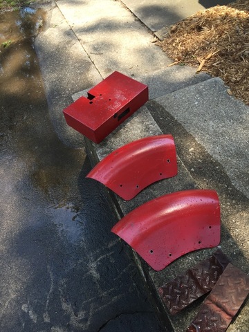

AlwaysLookin80 1,308 #6 Posted June 10, 2016 Got everything power washed today. I'll start paint prep this Sunday on some of the parts. I'll get the frame bare start on that part of the project next week. Gas tank is in great condition, and held water too. 6 Share this post Link to post Share on other sites
russellmc301 601 #7 Posted June 10, 2016 what are you useing to prep it? looks alot like my suburban right now Share this post Link to post Share on other sites

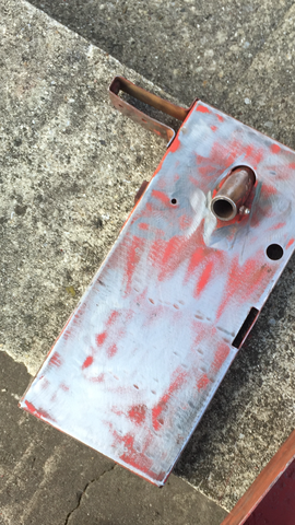

AlwaysLookin80 1,308 #8 Posted June 11, 2016 (edited) Wire brush it by hand, then a medium corse sanding followed by a fine grit sanding. Then I blow it off with high pressure air and wipe the parts down with mineral spirits on a rag, then when it dries , I wipe it with a clean dry cloth, then I prime and then paint. Usually works well for me. Edited June 11, 2016 by J.A. 4 Share this post Link to post Share on other sites

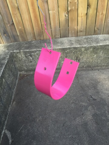

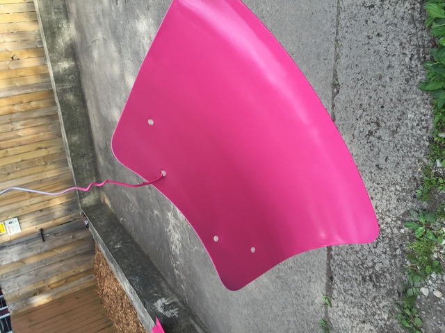

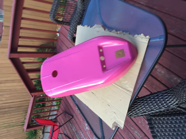

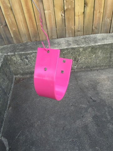

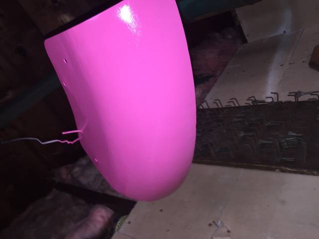

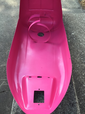

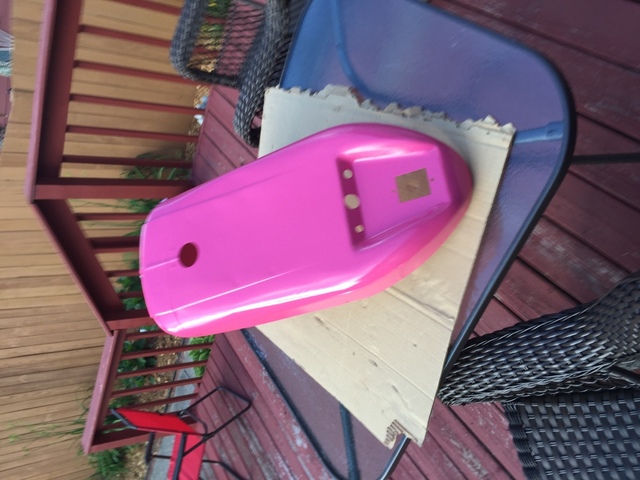

AlwaysLookin80 1,308 #10 Posted June 14, 2016 Prepped the hood, steering shaft and seat spring. Painted underside of hood, the seat spring and shaft this morning. 6 Share this post Link to post Share on other sites
JPWH 6,544 #11 Posted June 14, 2016 Paint job looks good. 1 Share this post Link to post Share on other sites
wrightorchid 261 #12 Posted June 14, 2016 What paint are you using? Looks great! 1 Share this post Link to post Share on other sites
AlwaysLookin80 1,308 #13 Posted June 14, 2016 Rustoleum 2x ultra cover painters touch primer and the same brand in color. Pricy but the only thing I could find in the color she wanted that had good reviews. 3 Share this post Link to post Share on other sites
Amcwheel85 2,059 #14 Posted June 14, 2016 That is gonna be awesome! It's even better when it's for your daughter that wants to have her own! My daughter love these tractors as well.. 4 Share this post Link to post Share on other sites
AlwaysLookin80 1,308 #15 Posted June 14, 2016 Im just waiting to see how the gloss looks when it's dry. I'll see tommarow Morning. I'll paint the top of the hood Wednesday. 5 minutes ago, Amcwheel85 said: That is gonna be awesome! It's even better when it's for your daughter that wants to have her own! My daughter love these tractors as well.. I know, makes the hobby even better when you can spend time with your kids doing it. 4 Share this post Link to post Share on other sites

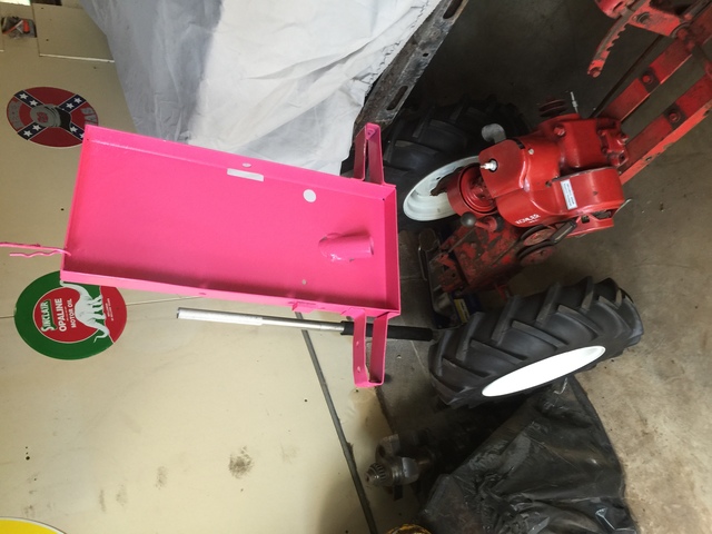

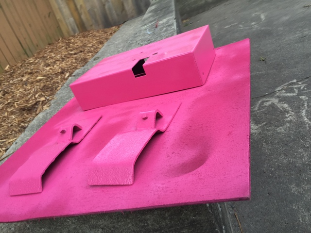

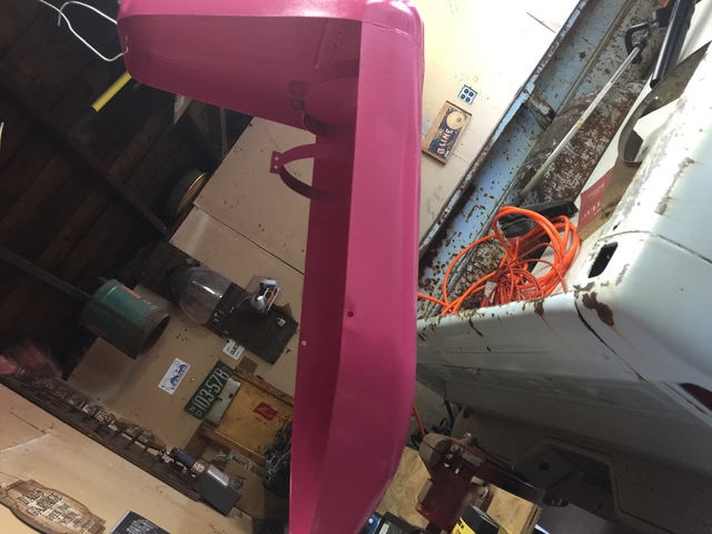

AlwaysLookin80 1,308 #17 Posted June 16, 2016 So all the pink parts are done except the inside of tool box and top of footrests. I'll paint those Saturday after the paint cures. I'm going to tear down the frame and trans and check everything and then paint those parts a tan color. I think I'm going to put a new predator 3hp engine on this one for her. More reliable. The Kohler is going to be repainted and put on my red suburban I restored last fall. 5 Share this post Link to post Share on other sites

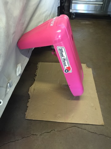

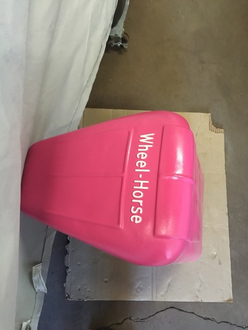

AlwaysLookin80 1,308 #18 Posted June 18, 2016 Put the stickers on and did the lettering. Not to thrilled about the glitter in the paint but it's not for me. Lol 6 Share this post Link to post Share on other sites

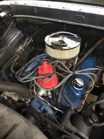

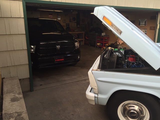

Pullstart 69,954 #23 Posted June 20, 2016 Great project with daddy and daughter, it's looking great! How about some info on that old truck in the garage too? Share this post Link to post Share on other sites
AlwaysLookin80 1,308 #24 Posted June 20, 2016 2 hours ago, pullstart said: Great project with daddy and daughter, it's looking great! How about some info on that old truck in the garage too? That's my 68 f250. Has mild 302. I drive that in the summer. The suburban in the back is the restored one in the first group of pictures. That's the day I picked it up. 2 Share this post Link to post Share on other sites
Pullstart 69,954 #25 Posted June 20, 2016 Great era, I've got a '69 C-10 with a mild 350, 3 on the tree that I love to cruise in. Thanks for the pictures! 1 Share this post Link to post Share on other sites
