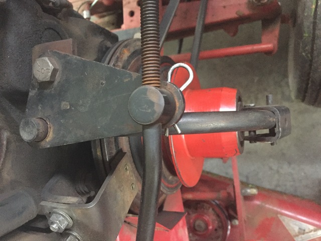

Hubbard414 32 #1 Posted June 3, 2016 Hello,. I have a 308-8 that I use for mowing. I just gave it a tune up, cleaned the deck and sharpened the blades. After putting everything back together I went out and started to cut the grass. I engaged the deck and it sounded fine but as soon as it hit grass the deck seemed to slow down, it was still cutting grass but leaving some. I had to mow everything twice. The motor wasn't losing power, and the belt was nice and snug. Any help would be greatly appreciated. Share this post Link to post Share on other sites
pfrederi 21,056 #2 Posted June 3, 2016 PTO Clutch may be slipping. Unhook the PTO rod from the clutch lever turn the trunnion in a turn and see if it helps. Share this post Link to post Share on other sites

Hubbard414 32 #6 Posted June 3, 2016 Thanks for the replies! I double checked the blades and they are installed correct. I believe pfrederi got this one, I turned the pto rod 1 half turn and that helped a lot, it cut much better. If i was able to turn the rod another half turn I think it would be perfect, but there's no treads left. Any ideas Here's a pic 2 Share this post Link to post Share on other sites
953 nut 68,546 #7 Posted June 3, 2016 15 minutes ago, Hubbard414 said: no treads left. Any ideas Guess you could run a die down the rod and cut a few more threads. 2 Share this post Link to post Share on other sites
Hubbard414 32 #8 Posted June 3, 2016 Great idea! Thanks Share this post Link to post Share on other sites

Marv 996 #12 Posted June 4, 2016 If you have run out of adjustment on the pto rod trunion the bearing in the end of the pto bell may be bad. Looks like you have plenty of shoe left. Marvin Share this post Link to post Share on other sites
Bert 804 #13 Posted June 4, 2016 My C-165 had the same problem, I just slid the pulley out on the crank about an 1/8th inch. Put it back together and problem solved If you have the same problem you'll notice a lot of space (side to side not up and down) between the belt and the guard. Share this post Link to post Share on other sites
Hubbard414 32 #14 Posted June 4, 2016 The bearing inside the pto bell is definitely bad there is a lot of play in it. I'll have to look into replacing that too Share this post Link to post Share on other sites
gwest_ca-(File Mod) 12,461 #15 Posted June 4, 2016 2 hours ago, Hubbard414 said: The bearing inside the pto bell is definitely bad there is a lot of play in it. I'll have to look into replacing that too Do that first and your adjustment problem will likely be solved. 109842 Toro bearing is Napa 7-04250 but take the old one with you to be sure. Garry 1 Share this post Link to post Share on other sites
