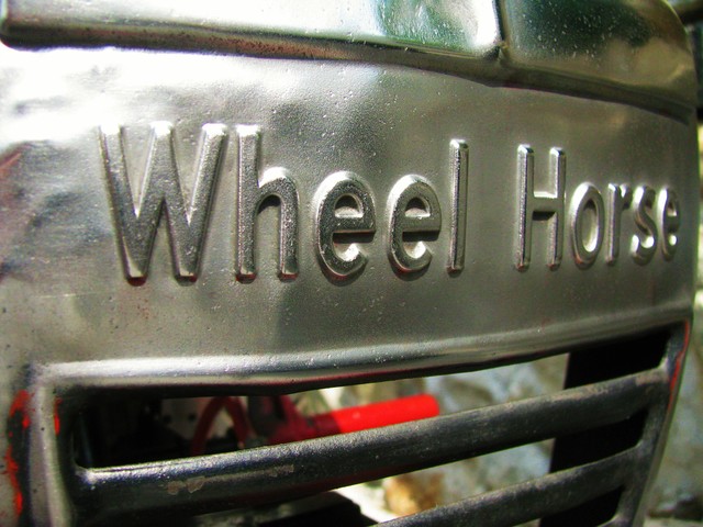

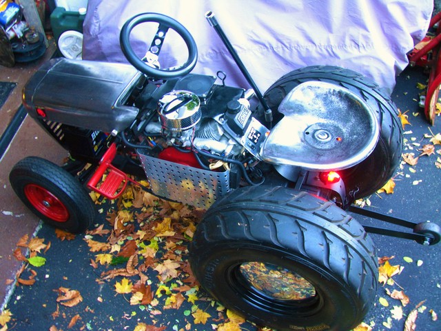

AMC RULES 37,260 #122 Posted November 23, 2016 (edited) So far...it's been over a year and a half... ...no significant has formed on the hood, or seat of the Grater. First... ...followed by. Edited November 23, 2016 by AMC RULES Share this post Link to post Share on other sites
