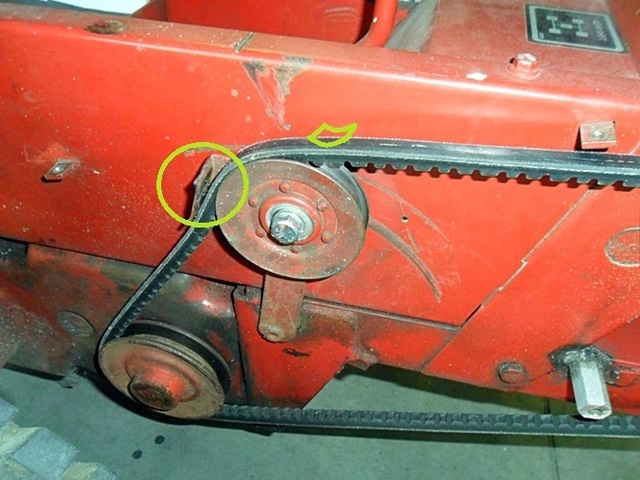

953 nut 70,331 #2 Posted May 30, 2016 Remove the belt cover from the 1054 and look at both. On the engine there should be a 3/16" bent wire device above the belt, be sure the 953 one is adjusted the same. Your cloth covered belt is fine! The idler pulley will have a metal device coming from behind the pulley that will "capture" the belt when the clutch is depressed; be sure it is rotated forward so as you push in the clutch it will contact the belt. The photo here is from another person who had this problem. Back off the bolt on the idler a turn, rotate the arm forward and tighten it. Hope this helps and, 4 Share this post Link to post Share on other sites

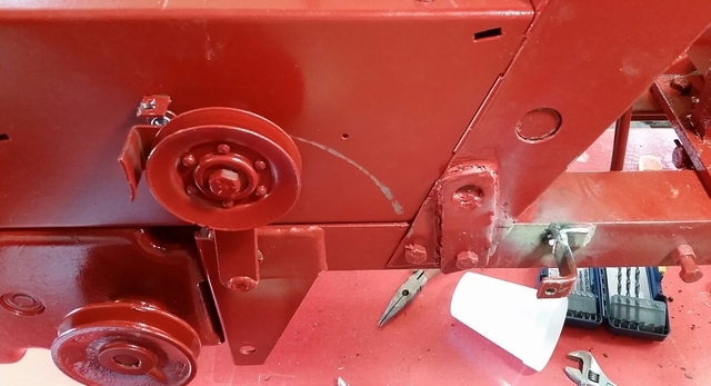

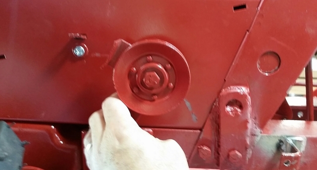

Texas Todd 1,026 #7 Posted August 1, 2016 On 5/30/2016 at 8:47 AM, 953 nut said: Remove the belt cover from the 1054 and look at both. On the engine there should be a 3/16" bent wire device above the belt, be sure the 953 one is adjusted the same. Your cloth covered belt is fine! The idler pulley will have a metal device coming from behind the pulley that will "capture" the belt when the clutch is depressed; be sure it is rotated forward so as you push in the clutch it will contact the belt. The photo here is from another person who had this problem. Back off the bolt on the idler a turn, rotate the arm forward and tighten it. Hope this helps and, Are you saying that the metal device should be rotated forward where you drew the yellow square? I can;t locate the belt on my 1056 and have one on order. I had to re-weld the angle bracket where your hex fix is in the picture. My top mount had to be fabbed and is juet behind the pulley. When releasing the pedal, the pulley bangs against the guard. I wasn't sure if the belt would hold it down to prevent that or not. I don't see a bent wire contraption nor can see where it would be installed. It appears to me the belt would have to hold the pulley at about this position to prevent the pulley from hitting the belt guard. The silver screw is the fab made for the top mounting bolt. And yes, that scratch before I got the cotter pin in place led to a little #$%^&. Share this post Link to post Share on other sites
953 nut 70,331 #8 Posted August 2, 2016 The reason the tab should be rotated forward is to capture the belt as the clutch is depressed and the idler moves toward the engine. 4 hours ago, HD-Horse said: don't see a bent wire contraption nor can see where it would be installed. This mounts on the engine above the drive belt to keep it from jumping off the pulley. Share this post Link to post Share on other sites
Texas Todd 1,026 #9 Posted August 2, 2016 (edited) Any chance of a picture of it? Also a properly positioned tab? If it is inded the yellow square that was drawn in the picture above, i understand that. I guess that would prevent the pulley from hitting the belt guard as well. Thanks! Edited August 2, 2016 by HD-Horse Share this post Link to post Share on other sites
