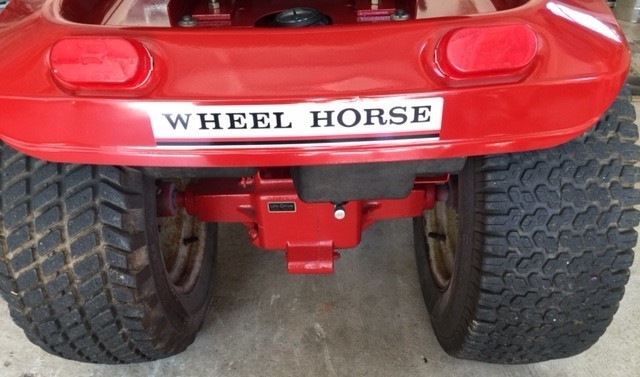

Tuneup 1,459 #1 Posted May 28, 2016 Hi everyone, It's time to spoon on new ones for the rears. The two there now are cracked, tubes pushing through the tread and mismatched. I'd like an aggressive tread but not the very tempting ag tread since this is a lawn machine for the most part BUT will have to go up steep hills so conservative turf savers may not fit the bill. Thinking ATV - Carlisle All Trail 23x8x12. So, what have y'all been able to do for an aggressive look and for performance without going nuts with spacing and other things? Mine is a 1980 C-125 Black Hood. Thanks! Share this post Link to post Share on other sites

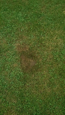

WVHillbilly520H 10,379 #8 Posted May 29, 2016 Actually AG tires DON'T tear up the grass/yard as you/one would assume yes they "bite in" but since you have good traction they don't loose it as fast as turf tires which spin out faster and leave more/worse spots in the yard like in the picture, don't have this issue with my original 520 with AG tires but with my latest 520 with Turfs and weights on both, my ,Jeff. 5 Share this post Link to post Share on other sites

JoeM 10,317 #13 Posted June 2, 2016 Tried all ways, ag, atv and super turf. I found when the ground is soft in the spring the ag tire will sink in and tear up if not careful. I mow on some very aggressive slopes and the atv tire have been the best. They do the best job of not sliding when crossing horizontally. The one thing that worked and I overlooked in the beginning is tire pressure. I was putting the recommended max pressure that was on the side wall causing the center of the tire to bulge. I have since reduced this to 15 lbs. so the contact area of the entire tire tread is on the ground. I wet the concrete and drove through the water then looked at the tread contact pattern. Adjusted the air accordingly. Traction greatly improved. Plus the ride is much better. I run these all trails on my 520 in the pic. I did install motor cycle chains on front tire to improve steering on the hill and to keep the front from sliding on the slopes. 2 Share this post Link to post Share on other sites
